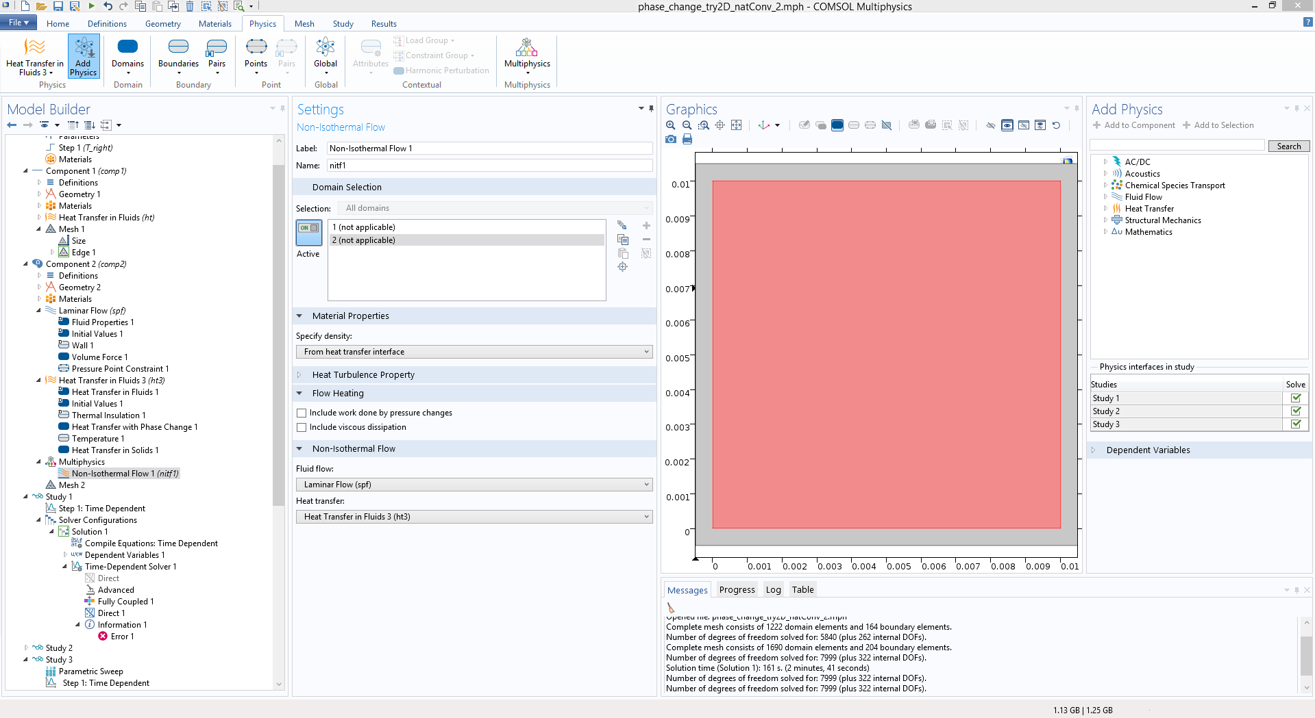

I am adding natural convection to a simulation of ice melting in 2d. I have added laminar flow as well as heat transfer in fluids with a 'heat transfer with phase change' and I have set the domains there for the solid and fluid.
However when I get to the multiphysics component, I am unable to select the fluid domain. All domains appear as 'not applicable'. Please see attached screenshot
Could someone please point out how I can resolve this issue?
Many thanks
Jesse

@Sohan, thank you for the reply.
I have the following selected
where 1 is the outside solid and 2 is the inside fluid
Heat transfer in Fluids 3 (ht3) : [1 & 2]
Heat transfer in Fluids 1 : [1 & 2 (both overridden)]
Heat transfer with Phase Change 1 : [2]
Heat Transfer in Solids 1 : [1]
in the Laminar Flow domain only domain 2 is selected
@Sohan, thank you for the reply. I have the following selected where 1 is the outside solid and 2 is the inside fluid Heat transfer in Fluids 3 (ht3) : [1 & 2] Heat transfer in Fluids 1 : [1 & 2 (both overridden)] Heat transfer with Phase Change 1 : [2] Heat Transfer in Solids 1 : [1] in the Laminar Flow domain only domain 2 is selected

Posted: 9 years ago 2016年11月30日 GMT+1 10:06
so it seems the only way I can select the fluid domain in the 'non isothermal flow' component is to disable 'Heat transfer with Phase change' in 'heat transfer in fluids'
Are these two modules not able to work together? If so, how do I manually couple the heat and fluid flow?
many thanks
Jesse
so it seems the only way I can select the fluid domain in the 'non isothermal flow' component is to disable 'Heat transfer with Phase change' in 'heat transfer in fluids' Are these two modules not able to work together? If so, how do I manually couple the heat and fluid flow? many thanks Jesse

Jonas Inhestern COMSOL Employee
Posted: 9 years ago 2016年12月6日 GMT+1 16:22
Dear Jesse,
the ability to combine Nonisothermal Flow multiphysics node with Phase Change Material feature has been introduced in COMSOL version 5.2a. We recommend to update to this version to benefit from this new capability. For further information please contact the COMSOL support team:
www.comsol.de/support
Jonas Inhestern
Dear Jesse, the ability to combine Nonisothermal Flow multiphysics node with Phase Change Material feature has been introduced in COMSOL version 5.2a. We recommend to update to this version to benefit from this new capability. For further information please contact the COMSOL support team: https://www.comsol.de/support Best regards, Jonas Inhestern
