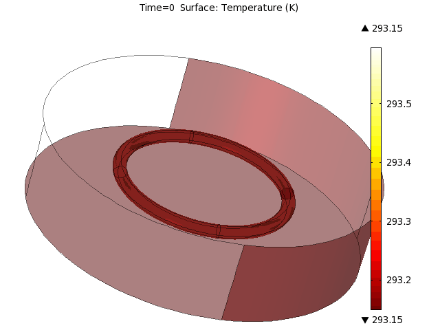

The attached model is one of the test models I have created to look at the Joule Heating model. It has a coil, which has constant current density on it, and I want to see the
I have two questions about the file:
Firstly, when I run the model, it sometimes solves and sometimes doesn't. It seems random - but sometimes it solves and gives me a plot where in all times, the whole model is in the same temperature for some reason; and sometimes it just doesn't solve - it gets stuck in a specific place while computing: in the progress bar you can see two rows - one is Time Dependent Solver (BDF), 0% progress, time parameter stuck on 0; the second row is Non-linear solver, 0% progress, step parameter stuck on value 1. it is just stuck like that, the only thing that seems to work is canceling the computation.
The next question is wierd just as well - if I increase the current density above 1 A/m^2, it *always* gets stuck, and never solves(even the wrong solution given at first is not given).
note that it does not give me any error messages.

Hi Ivar,
It seems that the file indeed got corrupted somhow, I think. In another file which seems perfectly identical to this one, the computation worked(I increased the current as you suggested, by the way).
In these results, however, there seems to be something wrong. I attacked a GIF file to show you the result - it looks like a heat diffusion from certain places on the coil, and clearly it shouldn't be that way, since the problem is totally symmetrical. The only thing I could think of that isn't symmetric is the mesh - perhaps refining the mesh would help?
Thanks,
Shoval

Hi again, Thanks for the answers.
Firstly I shall answer Ivar - the model above, in the first post, is outdated; the values of the model do have an effect and it is alright, so that is probably not the cause for a problem. I attached the model as it is now, with the results opened. note that the physics, the mesh and the time dependent nodes are the one I'm dealing with.
Secondly, I shall answer Nagi:
I defined the current as external current density alone. I saw no other way to have the current in this physics in a closed loop; note that if I have a loop that is not 360 degrees, I can use ground and terminal to define the current, and the model works perfectly. So since I want to deal with coils that form full loops, I want to treat them as one closed loop, where the magnetic field is just multiplied by N, the number of loops. So in this test run of Joule heating(no mention of magnetic field yet), is there any other way to define it without splitting the ring? I did not understand what you meant in the last sentence - "redefine the heat generation equation internally to J.J/sigma.".
If we're looking at the equations, E=-grad(V), so if we don't have potential there should be no electric field at all; however,
J=sigma*E+d/dt(D)+Je=0+0+Je, which is what I expected and wanted, basically. this forms nabla . J = Qj, so that the heat generation does seem okay, the way I see it. Correct me if I'm wrong of course :)
In general I faced the problem of how to apply a well-working current in a closed loop more than once while I worked in comsol, so perhaps you can enlighten me now in this matter, it'll be great.
Once again thanks for your time;
Shoval

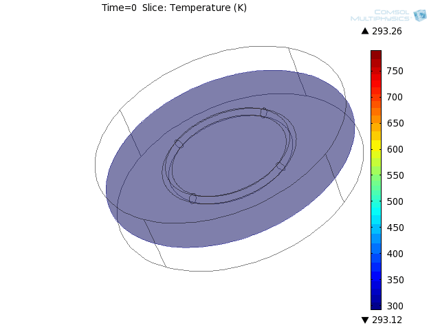

According to your advice, I figured it can't do any harm to rebuild the model, so I have, and I created once again the GIF file of the results - a horizontal slice(temperature), from time 0 to 1000(attached). here too, there seem to be two spots that look like their initial temperature was different.

Well the step function did not change a thing in the results. I'm definitely dazzled by the asymmetry here.
I attached the model as it is now, perhaps you can see why it is wrong. I noticed that you said earlier that you're using 4.2a - maybe it makes a difference - I'm using 4.2.
I also noticed that the current results, has at times areas with temperature lower than 293.15, the default for all the domains. clearly something is wrong. I cleared solutions to minimize file size - computation should take around 90 seconds.

In time dependent solving of thermal models of solids, if you get negative temperatures (or lower than the minimal ones) with only positive heat influx, it often indicates that you are not respecting the mesh size and time stepping correctly to resolve the thermal gradients you have.
There are two time constants in thermal one must whatch (often linked to the BIOT number for solids), particularly in time dependent solving:
1) the heat capacity time tc = rho*Cp*Vol/(h*Surface) where rho is the density [kg/m^3], Cp the heat capacity [J/kg/K], Vol is the domain volume [m^3] and S the surface [m^2], while h is the heat exchange parameter [W/m^2/K]. This is typically the thermal inertia of the domain.
2) But there is also the heat diffusivity alpha = k/rho/Cp where k is the heat conduction [W/m/K] and alpha has the dimensions of [m^2/s]. The corresponding diffusion time constant is td=L^2/alpha, where L in [m] is the caracteristic length considered (mesh size, or layer thickness or ...) y the way "ht.k" is no longer defined as a scalar in V4.2a (perhaps not in earlier versions either) one can use ht.kxx instead, the first diagonal heat conduction tensor element, (but do not get confused with the COMSOL "xx" tensor suffix notation, and the dependent variable "xx" suffix for second derivative along x, the first spatial direction ;)
if you select L to the average mesh size ("h" [m] in COMSOL not to be confused with the heat exchange "h" [W/m^2/K] used above) then it gives you a time value td you should ensure you respect in your time stepping. There is a simple model where I illustrate this in another thread (a few days ago)
Mostly, in our macroscopic world, the scaling of these time values do not give us issues with too short time stepping, or not fine enough mesh. So often one get good results without checking the td & tc.
But for i.e. MEMS devices: the different scaling of these time constants td & tc, as well as the fact that MEMS is often a set of metal and oxyde thin layers with very different alpha's, this can easily give you quite surprising results => numerical instabilities, temperature oscillating "waves", negative temperatures ... if one does not carefully check the meshing and the transient solver stepping settings.
Basically, there is no real difference here in HT, than with the fact that for RF, to resolve the electric field of a travelling wave, one need typically five 2nd order mesh elements per wavelength (in the material).
For all FEM models one need to have a mesh density that solves correctly the gradient of the fluxes, to get correct results, this applies to ALL physics
There are more on these values in good books on thermal flux transfer, just take a look at your local library.
Also thanks to Nagi, having stressed, here on the forum, already several times, the importance of respecting correctly the relations between mesh density and minimum time stepping. I have not found much on this subject in the COMSOL HT documentation, I hope they will take the hint for next release ;)
