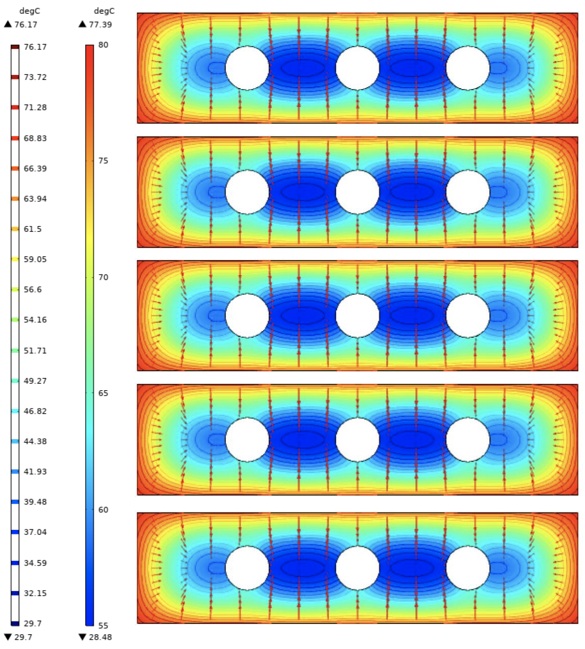

I am currently doing a lab report and I am meant to plot something like the figure I attached. I dont know how to plot more than 1 together or how to set a limit from 55degC to 80degC.
Kind regards.

Hi Penelope,
You can do it in this way:
  1. Create multiple sets of the plots used to create one of the plots (surface plus contour and arrow plots perhaps).
  2. For each such set except the first one, add Deformation subnodes with a suitable "deformation" in the y direction (and a scale of 1) so that the plots line up vertically.
  3. For the extra sets, inherit the color, data range, and other settings under Inherit Style from the corresponding plot in the first step.
  4. If desired use a manual color range in the "master plot" to get the desired values for the color legend (minimum and maximum temperature).
Magnus Ringh
