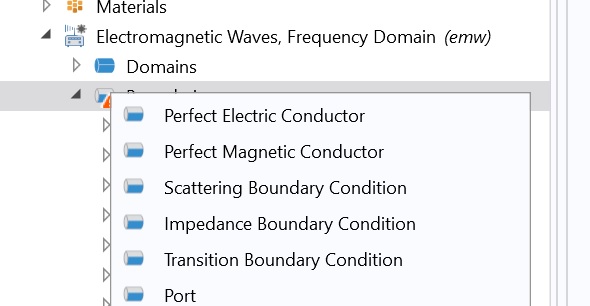

  3. In regard to defining PEC and PMC conditions, you can usually right-click on "Boundaries" and choose them from a list. This is done in the same way as assigning other boundary conditions in Comsol Multiphysics. If you are new to that, I encourage you to work through some of the tutorials. See the snapshot attached.
  4. Now, if by some chance your question was not about knowing how to use Comsol's interface to assign those boundary conditions, but rather that you don't know (or are unsure) which surfaces you should assign as PMC and PEC, well, unfortunately that's entirely for you to figure out. Remember, the code (along with your computer) is merely a mindless machine; ultimately, you have to tell it what to do.
