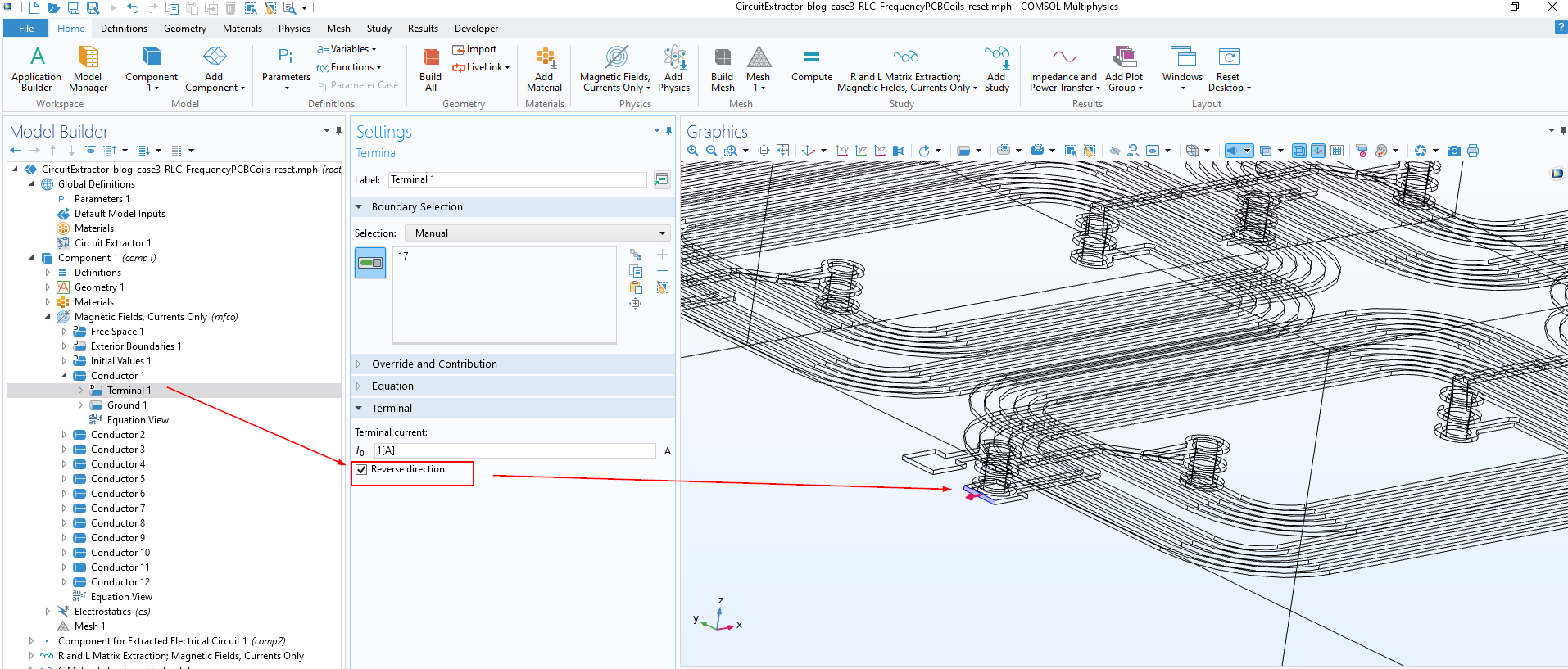

Hi Phanindra,

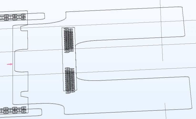

the direction of current flow is normal to the selected Terminal boundary. You can reverse the direction of current flow by clicking the respective button, see screenshot.
The depicted model is the "CircuitExtractor_blog_case3_RLC_FrequencyPCBCoils_reset.mph" from the following blog post: https://www.comsol.de/blogs/extracting-electrical-circuits-from-electromagnetics-simulations/
Kind regards, Philipp
Hi Phanindra, the direction of current flow is normal to the selected Terminal boundary. You can reverse the direction of current flow by clicking the respective button, see screenshot. The depicted model is the "CircuitExtractor_blog_case3_RLC_FrequencyPCBCoils_reset.mph" from the following blog post: Kind regards, Philipp

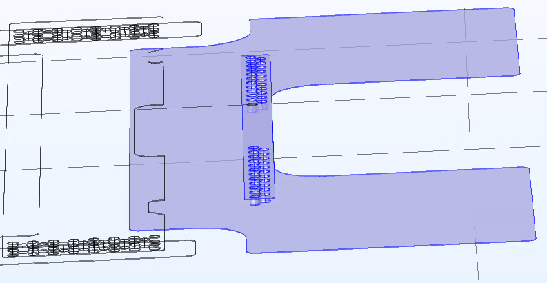

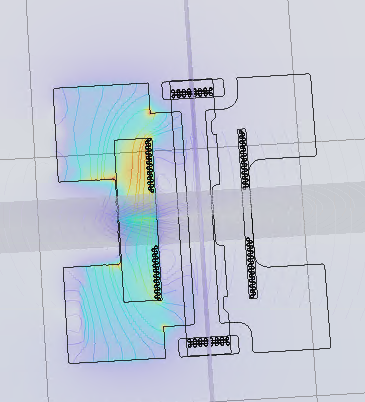

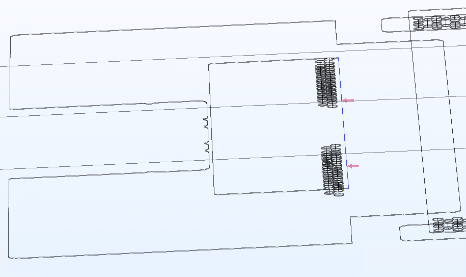

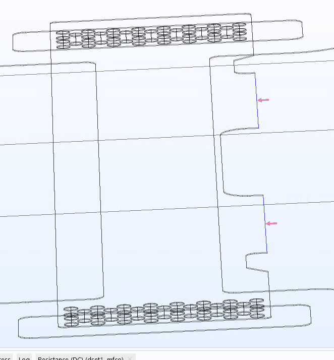

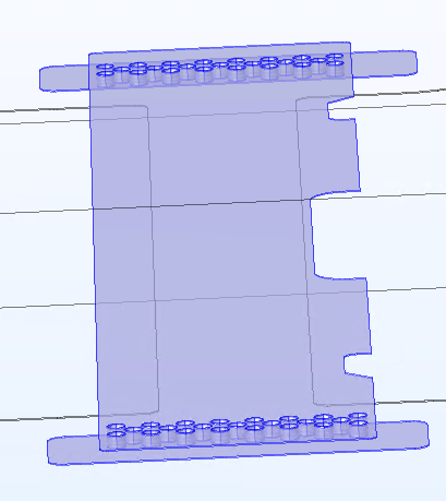

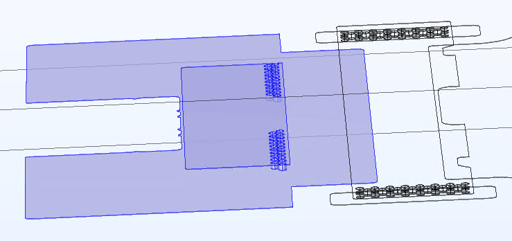

I am asking this because in my case I had 3 loops which I need to define the current flow in each power loop. I need to extract the INDUCTANCE due to these 3 loops in the module. I defined 3 conductor nodes and a Terminal sub-node for each conductor node. The solution I got does not has any meaning as per my knowledge. Even the Magnetic flux density Norm distribution is not correct. The Flux density distribution is only shown on one conductor side. Current flows in each conductor from Terminal face of each conductor in the direction shown by arrows.
Can anyone explain the solution for this case?
