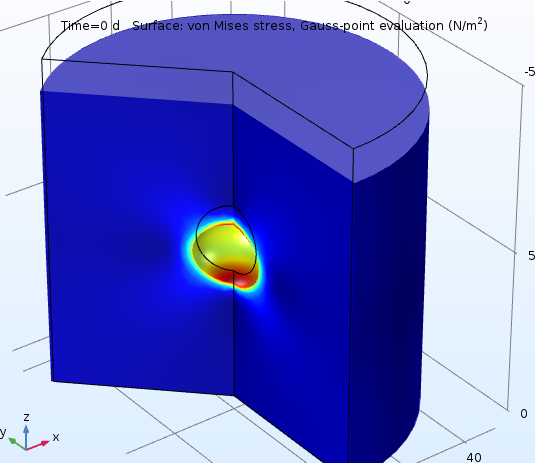

I have a solid that it deforms over time under the action of loads (elastic+creep).
The solid is a cylinder with a hole with sphere geometry (initial) in the center. With the passage of time the geometry of the sphere will change and also its volume. The problem I have is that the sphere is not a mesh domain, so I am not able to calculate its volume with a double integral and including 2pir (by clicking the postprocessing box), or creating an expression like this 2pir. I am able to calculate the surface of the contour but not the volume.
I solve the temporal evolution of the volume by including nonlinear geometry in the solver. And as an "approximation" to solve the problem I have included a material with properties of "air" in the hole. But I am concerned that as I make the model more complex, this jump between the properties of the cylinder and those of the artificial domain "air" that I have created could give me problems. I prefer being able to calculate the volume directly.
Somebody could help me? I've been looking at the Forum for days and there's a lot of information about axisymmetric 2D volumes but nothing works. I think the problem is the fact that I have to calculate the volume of a hole or external boundary.
Attached two pics.

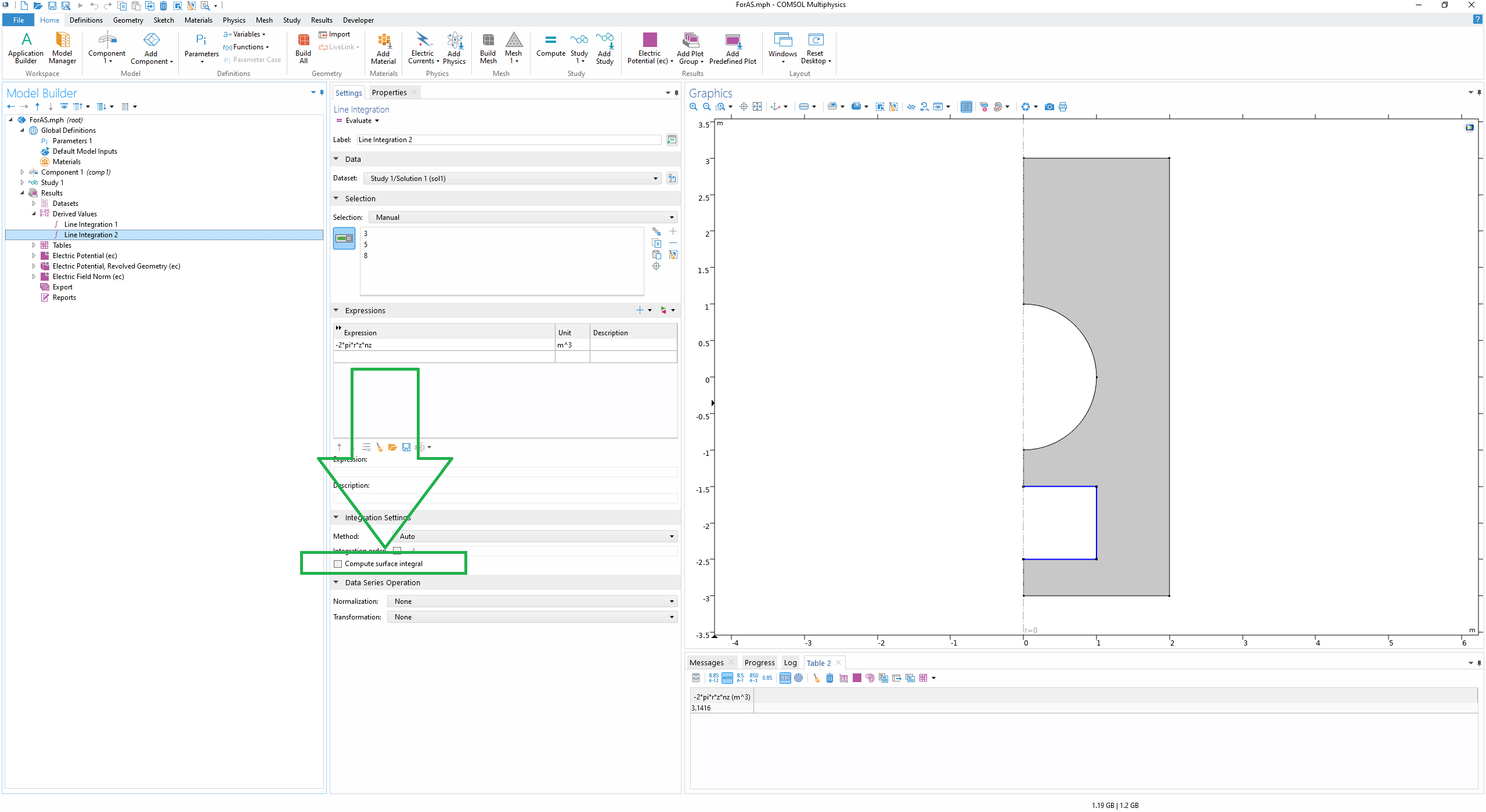

Dear Mr. Koslover,
Thank you very much for your reply.
I have applied this method and another variant that is , where dA would be dr*dz (area differential). However, neither of the two methods gives a correct result for a contrast test with a sphere of 10 m radius.
I think the problem is that the COMSOL simple integral operator calculates the line integral, that is: , where dS is the differential arc length of the boundary, but I would need it to do the integral: where dz is the height differential and I don't know how to do this.
Applying: "Results>Derived values>Line integration" on the boundary shaded in blue of the figure "hole_in_volume_2D_axi" with the "Expression (1)" half the length of the circle is obtained. And if I carry out the same operation, in that same contour but applying the "Expression ()" I obtain the surface of the sphere that encloses the volume that I want to calculate. In the case of a sphere, I could deduce the volume from the surface (as long as the deformation is low). But this does not interest me, I only use the sphere as a test to know that I am doing the calculations correctly, I need the volume to be calculated in a generic way for any type of boundary that generates a hole within the axisymmetric 2D model.
If you can help me I would greatly appreciate it.
Kind Regards, Andres

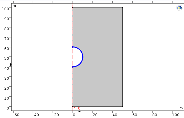

Hello Andres,
There is, as you suggested in another thread, an elegant solution based on the Divergence Theorem (DT) that does not require meshing the hole,
Here's how.
Start with the DT applied to the hole:
volume integral of div(F) = surface integral of (F.n)
where n is the normal vector pointing away from the hole
The trick is to choose F=z*ez
where ez is the base vector in the z direction.
Then div(F)=1 and the l.h.s. of the DT is the volume you want to compute.
The r.h.s. of the DT, accounting for the axisymmetry, is
line integral of 2*pi*z*r*nz
where nz is the z-direction component of the normal vector pointing away from the hole.
Voila!
This approach is implemented in the attached file. You can see that it checks out on a sphere and cylinder.
Notes: 1/ COMSOL's normal vector points away from the computational domain, so into the hole; that's why there is a minus sign in my implemented formula. 2/ I checked off the "compute volume integral" checkbox to take manual control of the axisymmetric integration.

Thank you very much for your explanation Jeff!
The proposed method works perfectly :)
In choosing the function to apply the DT, a Professor from my University has proposed another function:
So the divergence of this function would be:
Due to the properties of the Divergence, this value is invariant even if we change the cartesian coordinate system to cylindrical coordinates, those of an axisymmetric 2D problem. The function , however, changes its expression. Cartesian coordinates are written in terms of cylindrical coordinates:
and the orthonormal vectors in cylindrical coordinates:
Making the corresponding changes of coordinates and vectors in :
The normal vector to the surface expressed in cylindrical coordinates:
so the scalar product of the function by the normal vector is:
Returning to the formulation of the DT and writing the previous results:
So, as you can see in the last equation, in the line integral there is an initial term and in the second term (which is exactly the one you proposed) there is a 1/3 multiplicand.
Going over the expression and discussing it with theProfessor who gave me this function , since there is an nr component, it is possible that the calculation of the volume is a little more precise. I have performed the operations in COMSOL with the two expressions and they differ somewhat, not much, but somewhat.
I would like to know your opinion Jeff! :)
On the other hand, the note you left me: 2/ I checked off the "compute volume integral" checkbox to take manual control of the axisymmetric integratio" I don't quite understand, where does this option appear in COMSOL?
Thank you very much for your help,
Kind Regards,
Andres

Hi Andres,
You could also use
F=r*er
and then the volume integral on the l.h.s. of the DT is equal to
2*V
while the line integral looks like the initial term in your version of it (with a multiplicant). All of those approaches are essentially equivalent. Since things are axisymmetric in your work, I preferred not to introduce an F that breaks that axisymmetry. Your derivation will be easier to extend to non axisymmetric cases for other readers of this Discussion Forum, so thank you for taking the time to type it out.
As far as accuracy goes, I wouldn't expect that one F will intrinsically yield more accurate results than another. The integrals are computed via Gaussian quadrature so they are not exact, and which one is closest to the exact value will likely depend on the shape of the hole, the integration order, and the mesh.
Regarding my comment "I checked off the "Compute volume integral" check box to take manual control of the axisymmetric integration": It's a typo on my part - I meant to type "I checked off the "Compute surface integral" check box to take manual control of the axisymmetric integration", see attached screenshot and Reference Manual, version 6.1, page 411. My apologies.
Hi Andres, You could also use F=r*er and then the volume integral on the l.h.s. of the DT is equal to 2*V while the line integral looks like the initial term in your version of it (with a multiplicant). All of those approaches are essentially equivalent. Since things are axisymmetric in your work, I preferred not to introduce an F that breaks that axisymmetry. Your derivation will be easier to extend to non axisymmetric cases for other readers of this Discussion Forum, so thank you for taking the time to type it out. As far as accuracy goes, I wouldn't expect that one F will intrinsically yield more accurate results than another. The integrals are computed via Gaussian quadrature so they are not exact, and which one is closest to the exact value will likely depend on the shape of the hole, the integration order, and the mesh. Regarding my comment "I checked off the "Compute volume integral" check box to take manual control of the axisymmetric integration": It's a typo on my part - I meant to type "I checked off the "Compute surface integral" check box to take manual control of the axisymmetric integration", see attached screenshot and Reference Manual, version 6.1, page 411. My apologies. Jeff
