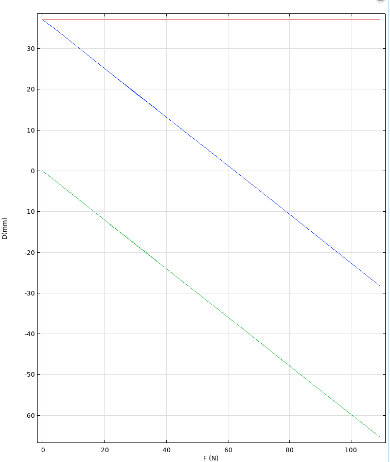

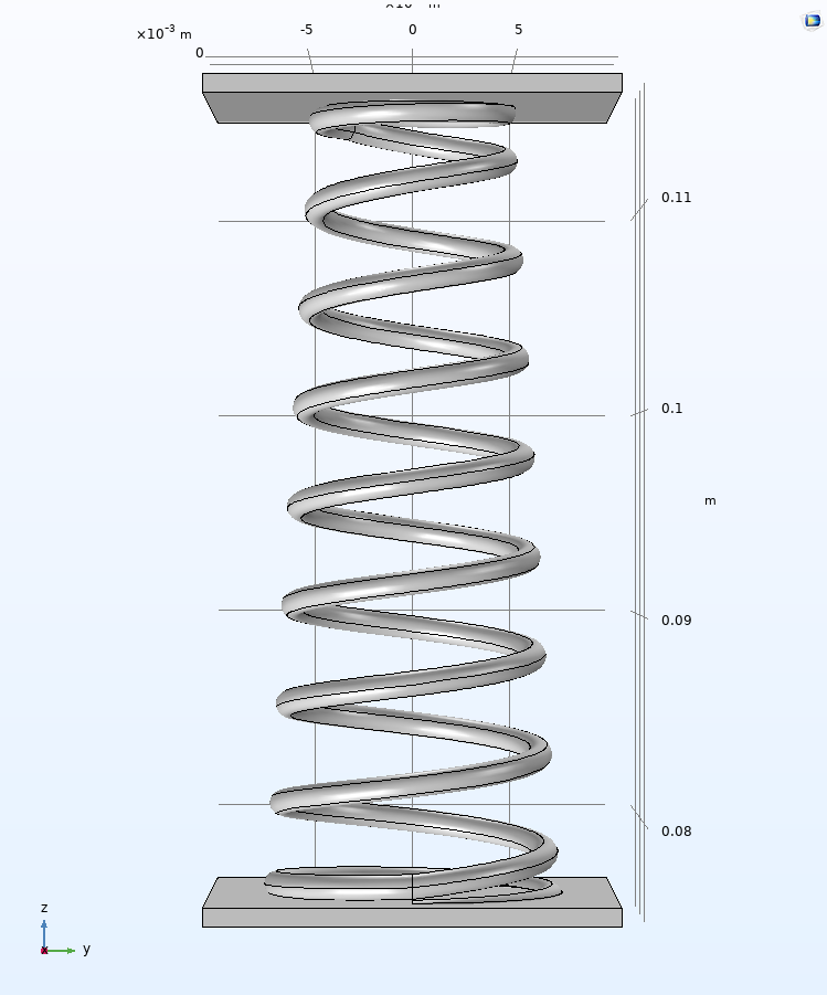

I am working on a conical spring using Solid Mechanics module in Comsol multiphyisics. Conical springs are caraterized for linear F vs D curve until it reaches the transition point. After the transition point the behaviour becomes non-linear. I have managed to setup parameteric equations for my study; I am doing a stationary study to investigate the non-linear behaviour of Force-axial deformation curve of a conical spring. I have a conical spring sandwitched between two flat plates. One of the plate is fixed and a force of the given magnitude is exterted on the other plate. I am using auxiliary sweep to add several force magnitudes in my study. The problem is that the Force displacement curve remains linear. I wonder what could be the reason? Here are some figures

Nine times out of ten, an unexpected linearity is caused by not having the Include geometric nonlinearity check box selected in the study.
