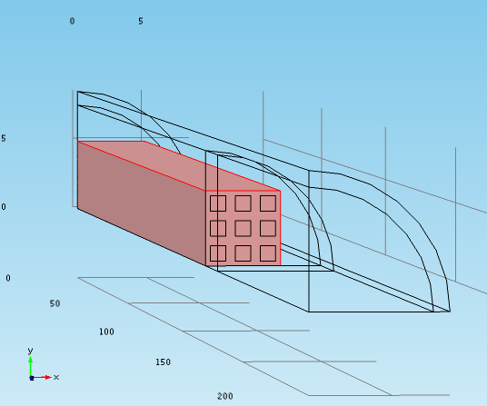

i'm studying heat transfer in a pipe where there is a SiC monolith surrounded by an insulating mat (see screenshot).
Up to now I have studied the system considering the monolith as pure solid using for my model only the Conjugate Heat Transfer physics.
Do I have to change physics to consider the monolith as porous?
If yes how have I to set the domain in the new physics?

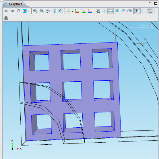

I'm trying to use the Darcy or Brinkman equations to simulate the flow through my porous monolith, but I haven't fully understood how these physics work.
First of all I don't know how to say that in one domain (see image) there are 2 different materials. This domain is the porous solid of SiC.
I want to simulate the air passing first in the pipe and later both in the free channels and in the porosity of the solid.
