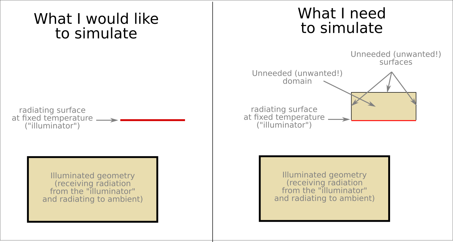

What I'm asking here is not a physical question, but a COMSOL one: suppose I have a geometry, and I want to calculate the heat distribution when I "illuminate" it with a uniform radiating surface of a specific size in a specific location. I can do this by adding to the model a box one of the face of which corresponds to my radiating surfaces. The problem is that now I have to deal with another 5 faces and a domain, that I don't need to (and actually would rather not have to) include in the simulation.
Rather than a COMSOL model, let me attach a picture illustrating the problem using an hypothetical simplified 2D model. Left is what I would like to obtain. Right is what I need to now, since I don't know how to include a radiating surface without it being part of a closed domain.
Hope this is clearer now.
Giacomo

Now again, the problem is: I have my domain representing the physical objects that are illuminated. I want to define a surface somewhere, at a fixed T>Tamb, that "illuminates" my object.
- If I create a domain (completely exterior to my illuminated objects, not "containing" them), then I can define one of its surfaces (looking towards the illuminated) as "emitting", and all works fine (see right panel on attached figure, in which I have colored the domain to make them easier to distinguish). However, I have the problem of having to include the additional domain, and its non-radiating faces, in the simulation.
- If I create just a surface, that would be ideal (left panel in the attached figure). Except, I do not know how to tell COMSOL to use that surface as a radiation source, since COMSOL only allows me to include domains, and not surfaces, in the "heat conduction" physics interface.
I hope it is now clear what my problem is...

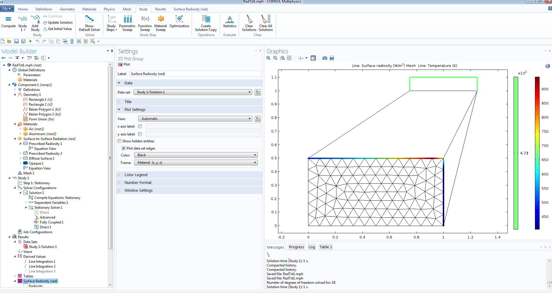

Sorry for not understanding your issue at once, but there are so many possibilities ...
Probably what puzzles me is that what you are asking for is, for me, what the "Surface to Surface Radiation" module is exactly doing (or allows you to do)
I have tried to regenerate your problem in the model below in v5.1.0.180
check carefully the doc too, I see now that COMSOL has nicely improved the capabilities since I used it last :)
Here I'm not solving for an T, I impose them you need to add the HT for that (or use the full HT+Rad case
Hi Sorry for not understanding your issue at once, but there are so many possibilities ... Probably what puzzles me is that what you are asking for is, for me, what the "Surface to Surface Radiation" module is exactly doing (or allows you to do) I have tried to regenerate your problem in the model below in v5.1.0.180 check carefully the doc too, I see now that COMSOL has nicely improved the capabilities since I used it last :) Here I'm not solving for an T, I impose them you need to add the HT for that (or use the full HT+Rad case -- Good luck Ivar

Unfortunately I cannot open the model you attached, as I'm limited to COMSOL 5.0. However, by looking at the screenshot, I do have a comment: I don't think you need to insert the two extra domains (triangle and trapezoid) besides the two rectangles.
