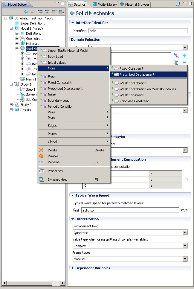

That's the strange thing. I've run structural mechanics models before (Just force and displacement models, no thermal stress) and I have the options to apply loads and constraints to the model, just no thermal load option. I've attached a screenshot of the options available to me under the Solid Mechanics heading in the model builder menu.

The screenshot is fully consistent with your license having neither the Structural Mechanics Module nor the MEMS Module: only those structural mechanics capabilities featured in the base package are available to you.
If in doubt about which modules your license includes, go to the Options>Licenses menu to check on that.
The screenshot is fully consistent with your license having neither the Structural Mechanics Module nor the MEMS Module: only those structural mechanics capabilities featured in the base package are available to you. If in doubt about which modules your license includes, go to the Options>Licenses menu to check on that.

That explains it - I didn't realise that any structural mechanics options came with the base version of the program, so I thought I had the whole lot. Thanks for clearing that up, you've saved me hours of wondering whether I've missed something obvious.
