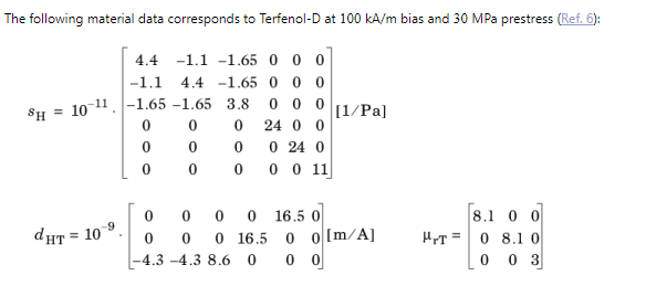

You have a couple of issues in your model.
  • No piezomagnetic domain is defined for the core in the solid physics.
  • The solver is not defined
  • Compliance matrix, coupling matrix are all zero
  • Relative permeability is not defined
There may be other errors. I suggest you look into the nonlinear magnetostriction example in the application library to learn how to properly set up the magnetostriction part.
Cheers Edgar
Well first i wanna say thanks, i will for sure take a look into that. But could i ask what do you mean with the solver is not defined?
Also where can i find the expression for Compliance matrix, coupling matrix? And Piezomagnetic coupling matrix, Voigt notation?
Also did you find any other parts missing in the solid mechanics? Like constraints etc?
>You have a couple of issues in your model. > >- No piezomagnetic domain is defined for the core in the solid physics. >- The solver is not defined >- Compliance matrix, coupling matrix are all zero >- Relative permeability is not defined > >There may be other errors. I suggest you look into the nonlinear magnetostriction example in the application library to learn how to properly set up the magnetostriction part. > >Cheers >Edgar Hello, Well first i wanna say thanks, i will for sure take a look into that. But could i ask what do you mean with the solver is not defined? Also where can i find the expression for Compliance matrix, coupling matrix? And Piezomagnetic coupling matrix, Voigt notation? Also did you find any other parts missing in the solid mechanics? Like constraints etc?
Posted: 2 years ago 2024年5月14日 GMT+2 15:38
There wasn't any solver sequence, probably due to the missing piezomagnetic domain and the resulting error. COMSOL stopped before building the solver sequence.
Material data for magnetostriction is a difficult point. You can find data for the material used in the library example (a giant magnetostrictor like Terfenol, used for tranducers), but that is not valid for Iron. Iron and polycrystalline ferrous materials have a more complex magnetostrictive function. Also the current nonlinear magnetostrictive approach in COMSOL is not really suitable for materials like Iron, even if you had a magnetostrictive function. You may get a result but it is probably not correct.
I developed a method for the linear case with DC bias and a small AC perturbation, but this is not suitable for a transformer.

There wasn't any solver sequence, probably due to the missing piezomagnetic domain and the resulting error. COMSOL stopped before building the solver sequence. Material data for magnetostriction is a difficult point. You can find data for the material used in the library example (a giant magnetostrictor like Terfenol, used for tranducers), but that is not valid for Iron. Iron and polycrystalline ferrous materials have a more complex magnetostrictive function. Also the current nonlinear magnetostrictive approach in COMSOL is not really suitable for materials like Iron, even if you had a magnetostrictive function. You may get a result but it is probably not correct. I developed a method for the linear case with DC bias and a small AC perturbation, but this is not suitable for a transformer.
Posted: 2 years ago 2024年5月14日 GMT+2 15:43
Could i use another material for the core then to get it to work?

Here is some good reading about magnetostriction. It is mostly about magnetostrictive transducers, not about transformers. However, it shows the magnetostrictive function of a typical low carbon steel (page 25) and how to derive a coupling matrix from that. It is good for general understanding, but will be a long way to model magnetostriction in a transformer.

Read thru it but still is it even possible to find desired magnetoelastic properties for Silicon Steel GO M-6 Rolling on internet?
Also could i ask you quick do i need some constraints in the solid? Or can i just leave it free

In a time dependent study the solid can be free, in a stationary study the rigid body DOFs must be constrained.
I was doing extended research regarding magnetostrictive properties in the internet, but didn't find much relevant. You may consider to inquire with manufacturers. Of course it is possible to measure magnetostrictive properties of specific materials. Then you still need a nonlinear method that can handle the non-monotonous behavior of Iron based materials.
