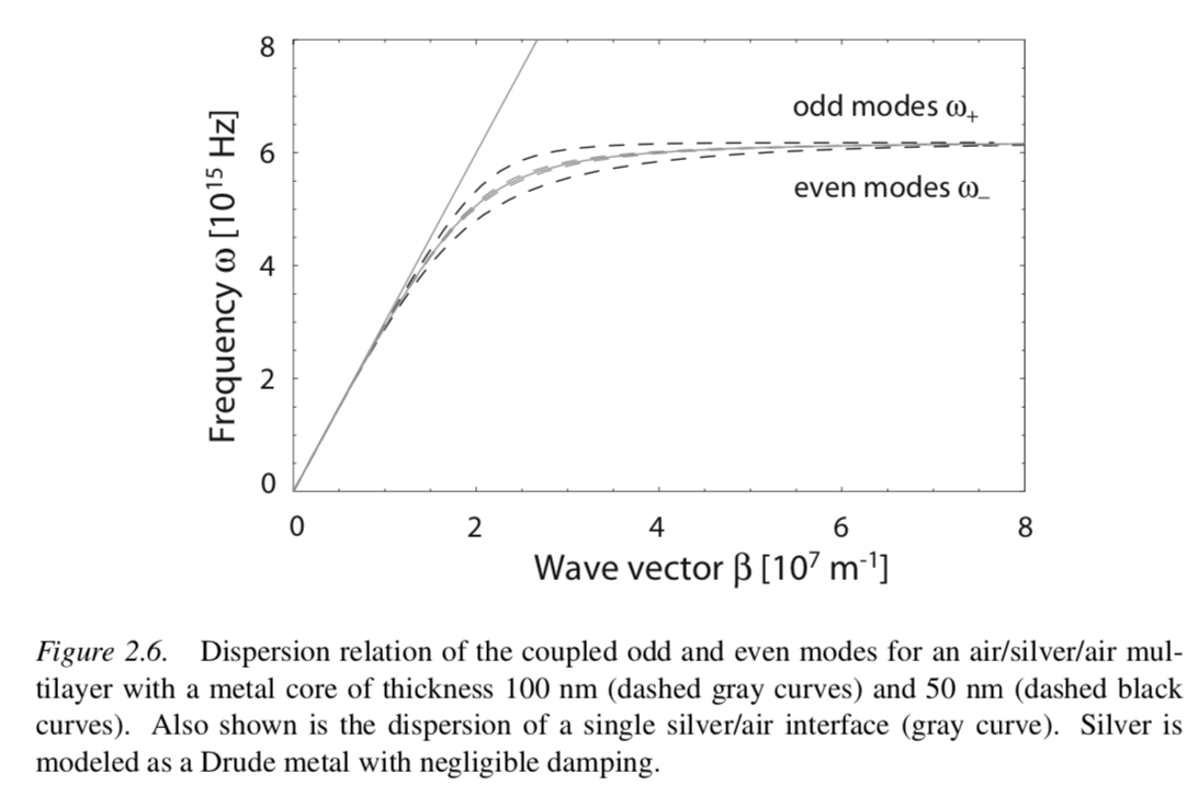

I am interested to obtain dispersion curves (\omega vs \beta) of a loss-less film of silver with thickness of 50 nm which is bounded with air. The dispersion curves are illustrated in Fig. 2.6, page 32 of this book: "S. A. Maier, Plasmonics: Fundamentals and Applications (Springer, Berlin, 2007)" .
According to this figure, I expect to obtain two branches of SPP dispersion. To this aim, I prepared my model with following method:

However, I could not obtain dispersion curves. It is simply different from the book result.
