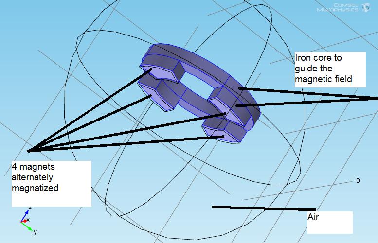

           Hi Robert,
Thank you for your response.
Yes, I followed his suggestion: In fact, I deleted the external current density and I get the same problem: singular matrix
My prblem is how to build in COMSOL the permanent magnets alternately magnatized (it is an NdFeB magnets) as shown in the attached file. it will be greatful if you help me.
Thank you!
Regards
John J

Why do you use MEF (which solves for the magnetic field and for V ?) isnt it enough with MF?.
As MF is far simpler to set up. in MEF you need to give some conduction to all materials (including air)and yo have far moe DoFs t solve. If you do not use any Eddy current analysis, use rather MF. For me you can set up the magnets by adding two amper law physics with magnetisation for the two pairs ofmagnets, such to polarise them correctly, or you can use a cylindrical coordinate and use a condition on the phi angle to get the correct sign of the magnet polarisation
           Hi Why do you use MEF (which solves for the magnetic field and for V ?) isnt it enough with MF?. As MF is far simpler to set up. in MEF you need to give some conduction to all materials (including air)and yo have far moe DoFs t solve. If you do not use any Eddy current analysis, use rather MF. For me you can set up the magnets by adding two amper law physics with magnetisation for the two pairs ofmagnets, such to polarise them correctly, or you can use a cylindrical coordinate and use a condition on the phi angle to get the correct sign of the magnet polarisation -- Good luck Ivar

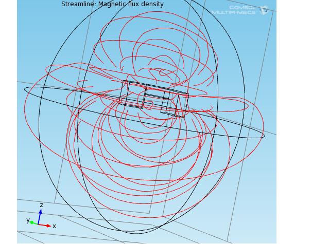

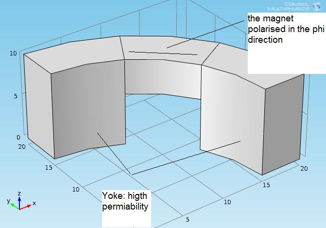

           Thank you for your response Ivar,
Because I am working in eddy current anaysis so I must use MEF.
As, you have said, it is possible to set up a cylindrical coordinate and use a condition in the phi angle for the magnets's polarisation. It works for me, but the only problem is that the streamlines of the magnetic flux density are not totally guided by the Yoke? (see fig1 and fig2).
Thank you again Ivar.
Regards.
           Thank you for your response Ivar, Because I am working in eddy current anaysis so I must use MEF. As, you have said, it is possible to set up a cylindrical coordinate and use a condition in the phi angle for the magnets's polarisation. It works for me, but the only problem is that the streamlines of the magnetic flux density are not totally guided by the Yoke? (see fig1 and fig2). Thank you again Ivar. Regards.

you will always get some field outside your iron, check the streamline settings and use another rule for magnitude, in your image it might be that 90% of the field is still in the yoke
           Hi you will always get some field outside your iron, check the streamline settings and use another rule for magnitude, in your image it might be that 90% of the field is still in the yoke -- Good luck Ivar
