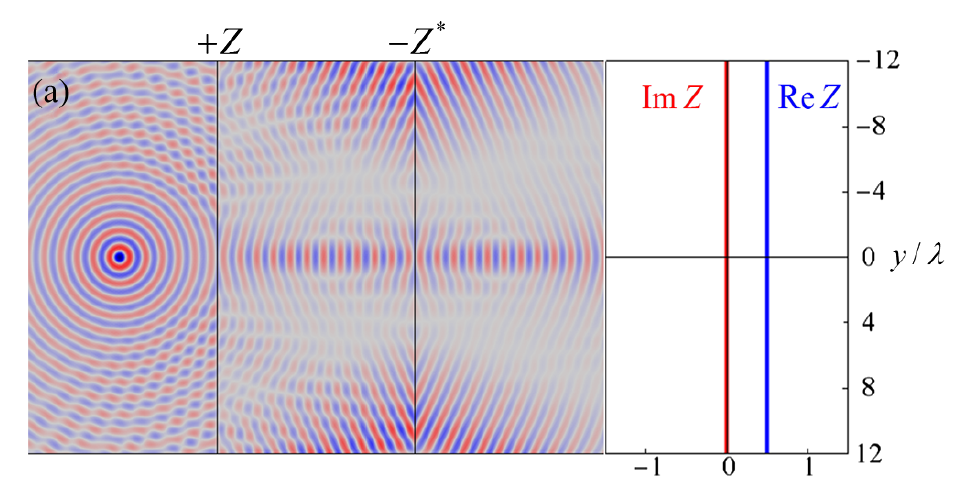

Thanks for your reply. Its an RF problem. I have attached an image below how I want it to be.

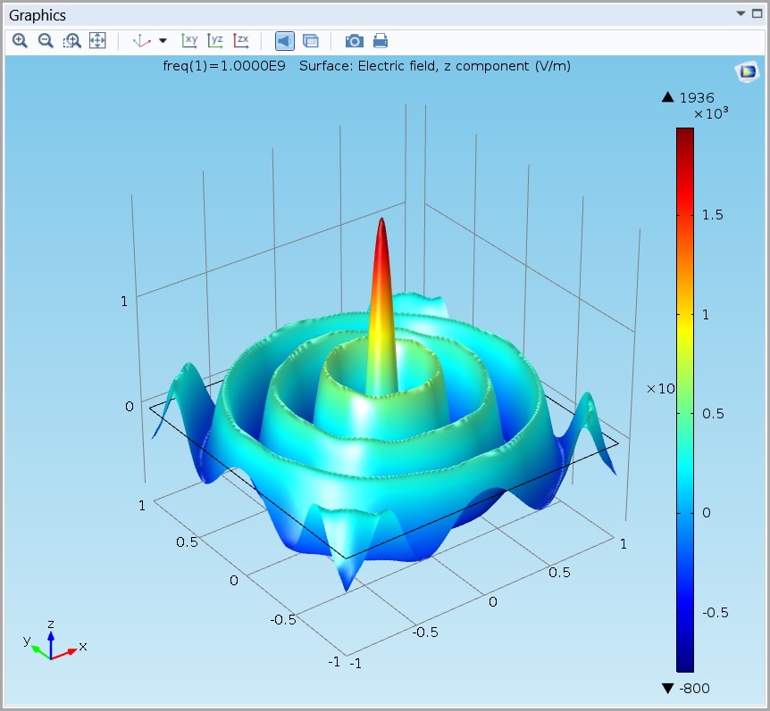

I've attached an example.

Hi Dear sir its very useful file. But once i simulated then its field is inverted as compared to yours plot. Then i needed to put -1A to get same like plot of yours, whereas you put 1A. Where am i making mistake?

Hi Sir I found correction. You used study at 180 degree and by default its at 0 degree. Whats reason behind out of phase plotting the data?

I plotted it that way because the resulting plot was prettier. The plot is just a snapshot at a particular phase. Feel free to pick and plot any other phase snapshot of the solution that you prefer.

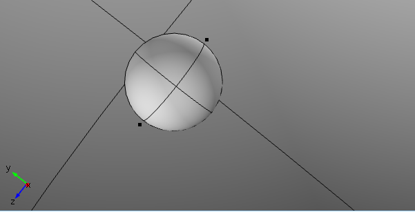

I want to add 2 electric field sources around sphere. I used 2 electric point dipole in 3D around it on the same axis(z).
1- I determine 2 physical points and then linking between them and dipoles.
2- After that I choose the dipole moment option and I get 3 data entries for x, y and z, I know that these values determine the polarization of dipole moment and according to these values the power will be perpendicular to the polarization direction.
My first question is how can I determine the polarization direction and the physical points play a role in that.
The second: how could I convert from [A.m] unit to electron volt.
The attached pic is my structure and it is radio frequency model
Thanks in advance
