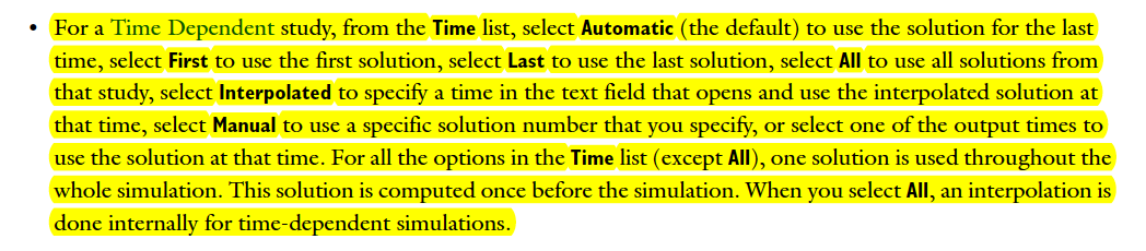

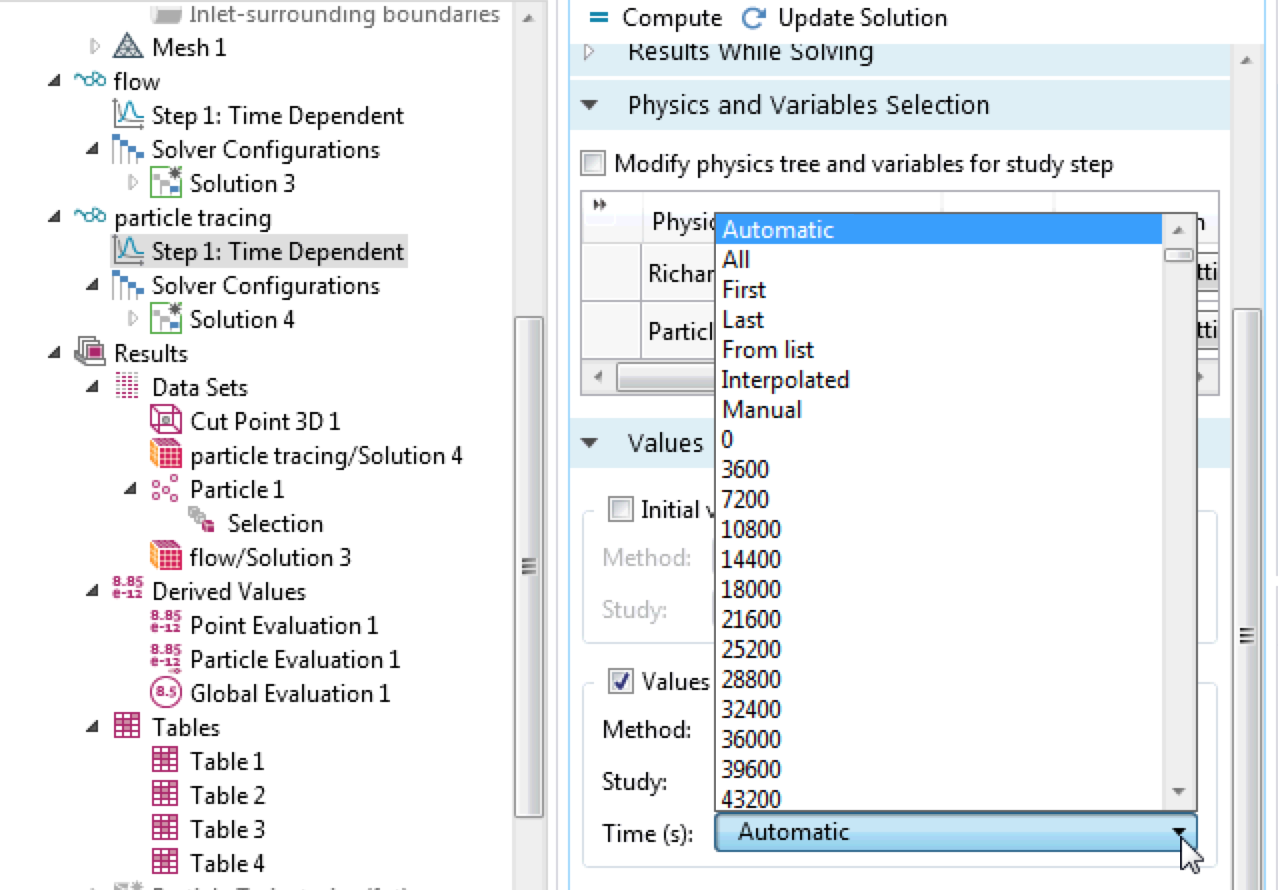

Hi all!
I have two physics, both of them are time-dependet study.
My question: If I want to couple these two physics together , there are two options:
Values of variables not solved for: Time(s)
"Automatic"
"All"
what is the difference between these two option?
