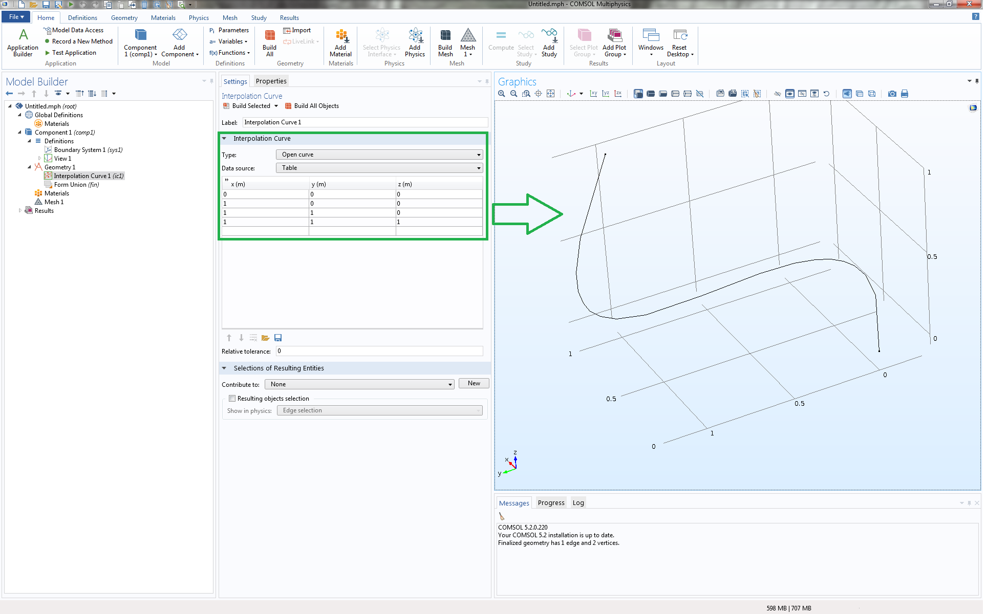

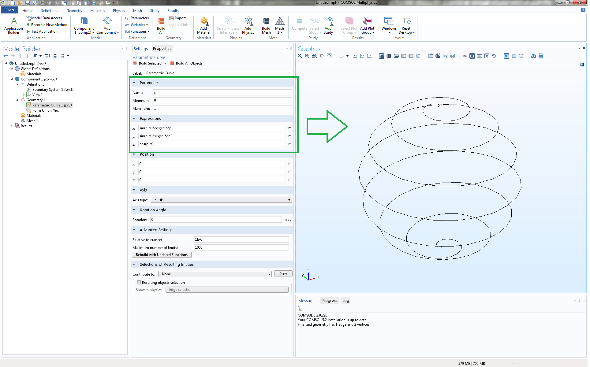

These 1D curves can be created in a number of way, the most flexible options being "Parametric Curve" (When you know an equation for the curve) and "Interpolation Curve" (When you know the coordinates of a few points on the curve), and they can be embedded in 3D objects to represent the interaction of the pipe with its surroundings.

One is illustrated in the attached file: you create a custom function to specify one period of the planar curve, then use an analytic function to "periodize" it, and finally you use a parametric curve to "wrap it around a cylinder".
Alternatively, you could build this geometry programmatically using the App Builder (or LiveLink for MATLAB if you have MATLAB): each straight segment and each curved segment is easy to draw with its own parametric curve, and then it's just a matter of doing a for loop.
