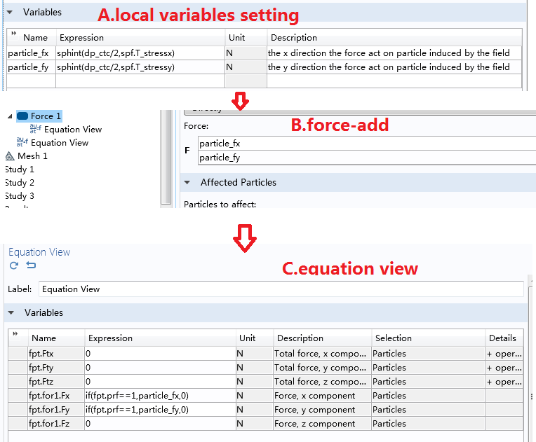

here is the “force-add” solution;
the particle remain the at the location
here is the “force-add” solution; the particle remain the at the location

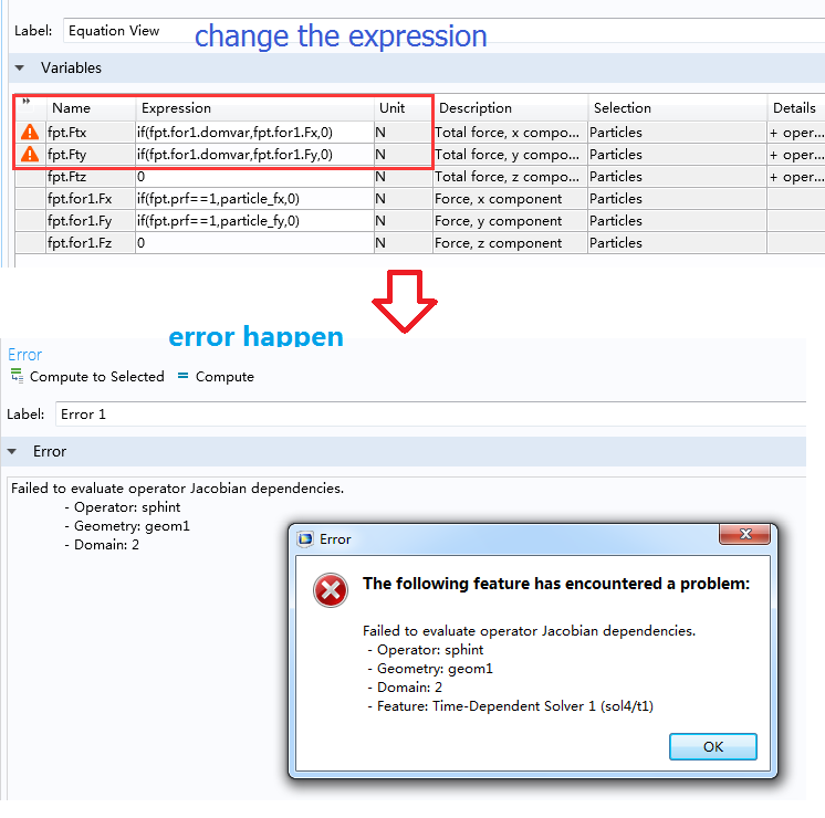

I noticed the “equation view> expression”,fpt.Ftx,Fpt.Fty equal to zero;
So I changed the expression “Referring to the other force‘s expression”,
but when start the calculation, there errors happens
I noticed the “equation view> expression”,fpt.Ftx,Fpt.Fty equal to zero; So I changed the expression “Referring to the other force‘s expression”, but when start the calculation, there errors happens
