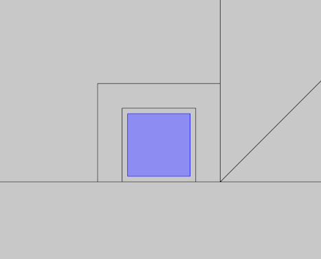

The square part which I attached as model.png is the pipe and inside.

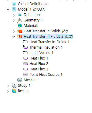

I built two point source inside.
Inside the pipe is just air, so I applied the heat transfer in fluid.

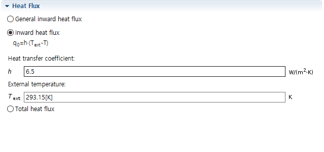

Wanted to apply convective heat flux to the pipe walls, but there was only inward heat flux in my version.
So I just applied the inward heat fluxes to the walls.

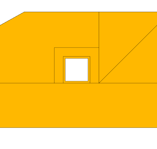

However, the result came out like result.png. Even though I applied heat transfer in solid and heat transfer fluid for the analysis, it doesn't read the heat conduction or convection inside the pipe box at all.
