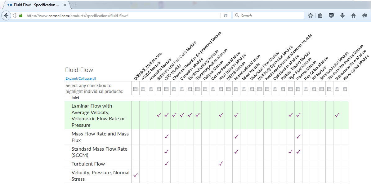

Hello Lauren,
Please also be aware that several of the COMSOL Modules come with a built-in Laminar Inflow (and Outflow) boundary conditions that will automatically set up the appropriate laminar velocity profile for any arbitrary cross-sectional shape.
The specification chart details this information:
www.comsol.com/products/specifications/fluid-flow/
The attached screenshot from that page shows the Modules that include this boundary condition.
If, on the other hand, you are working purely with the base COMSOL Multiphysics package then yes, you will need to manually set up the appropriate equations.
Best Regards,
