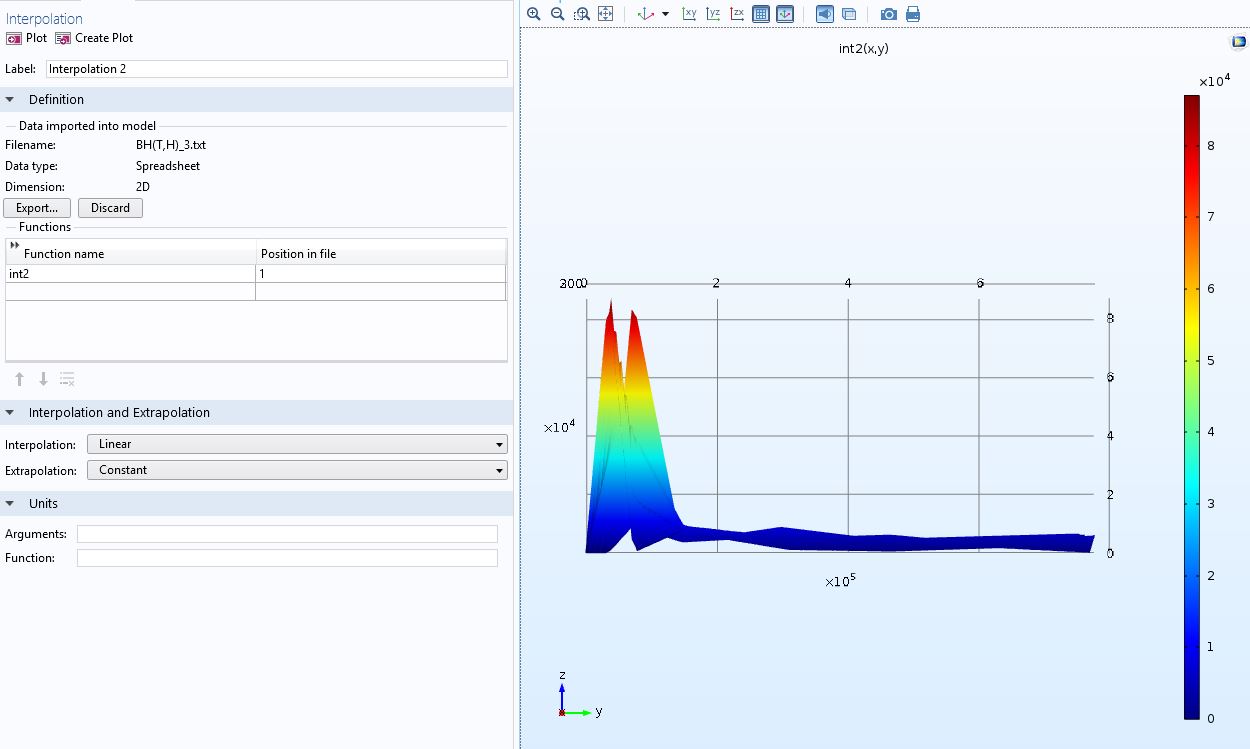

Dear Edgar,
thanks again for your help! I don't want to borther you to much but I have some more questions:

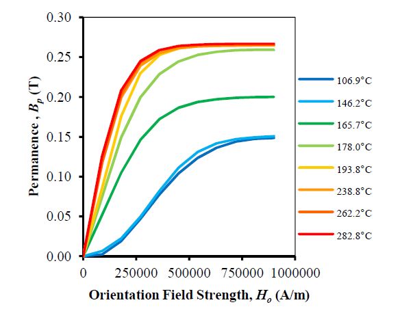

I tried to create a 2D interpolation for my B(T,H) function but unfortunately it hasn't worked like I expected.
I expected a graph similar to the picture: B(T,H).jpg but COMSOL creates this: B(T,H)_COMSOL.jpg. The data of the .txt (all in one file) file I used you can find below.
I do not understand what COMSOL is creating there especially because of the axis scale and the course of the graph. I know that the B(T,H) function can be displayed on an area using two axis for the arguments and colors for the function value, but in this case I don't see where the graph fits the data I have given COMSOL.
In the end COMSOL should be able to calculate the flux density B[T] based on the given parameters T [°C] and H[A/m] whereas the temperatur T will be imported from another simulation as I mentioned before.
Can you pls give me a hint what I'm doing wrong? Do I have to format my data in a different manner or do I have to split the data into several .txt files?
I don't know how to move on right now and I hope you can help me again!
Thank you very much!
Maximilian

Dear Edgar, thanks again for your help! I don't want to borther you to much but I have some more questions: I tried to create a 2D interpolation for my B(T,H) function but unfortunately it hasn't worked like I expected. I expected a graph similar to the picture: B(T,H).jpg but COMSOL creates this: B(T,H)_COMSOL.jpg. The data of the .txt (all in one file) file I used you can find below. I do not understand what COMSOL is creating there especially because of the axis scale and the course of the graph. I know that the B(T,H) function can be displayed on an area using two axis for the arguments and colors for the function value, but in this case I don't see where the graph fits the data I have given COMSOL. In the end COMSOL should be able to calculate the flux density B[T] based on the given parameters T [°C] and H[A/m] whereas the temperatur T will be imported from another simulation as I mentioned before. Can you pls give me a hint what I'm doing wrong? Do I have to format my data in a different manner or do I have to split the data into several .txt files? I don't know how to move on right now and I hope you can help me again! Thank you very much! Best regards, Maximilian Data I'm using: T H B(T,H) 180 0 0 180 35000 0,120841051 180 72184,87395 0,2292412 180 145581,3953 0,347647366 180 297435,8974 0,584071916 180 448092,4855 0,812329841 180 750819,6721 1,242874621 240 0 0 240 35000 0,120841051 240 71769,9115 0,223878598 240 147636,3636 0,380603987 240 305420,5607 0,630880757 240 460611,3537 0,850953617 240 771428,5714 1,269559816 260 0 0 260 35833,33333 0,163519166 260 72587,41259 0,225797369 260 149494,9495 0,410923505 260 308070,1754 0,641295296 260 463933,0544 0,85650051 260 772727,2727 1,271826102 280 0 0 280 36100,91743 0,164107652 280 72375 0,269951601 280 150048,7805 0,417137603 280 308225,1082 0,644087549 280 465882,3529 0,852916826 280 775206,6116 1,268532415 300 0 0 300 36153,84615 0,198026975 300 72486,18785 0,290782945 300 150471,6981 0,423541366 300 308669,5279 0,645492789 300 464050,6329 0,854344051 300 775000 1,266806084

The decimal comma may be the culprit. Comsol needs a decimal point. For what you want to do, you need the 2D interpolation B(T,H). If you want a multitude of curves you have to import 1D interpolations seperately for each temperature. But I guess this won't get you where you want to get.

That was easy, thanks! Finally it worked...
I hope I am able to do rest on my own =).
