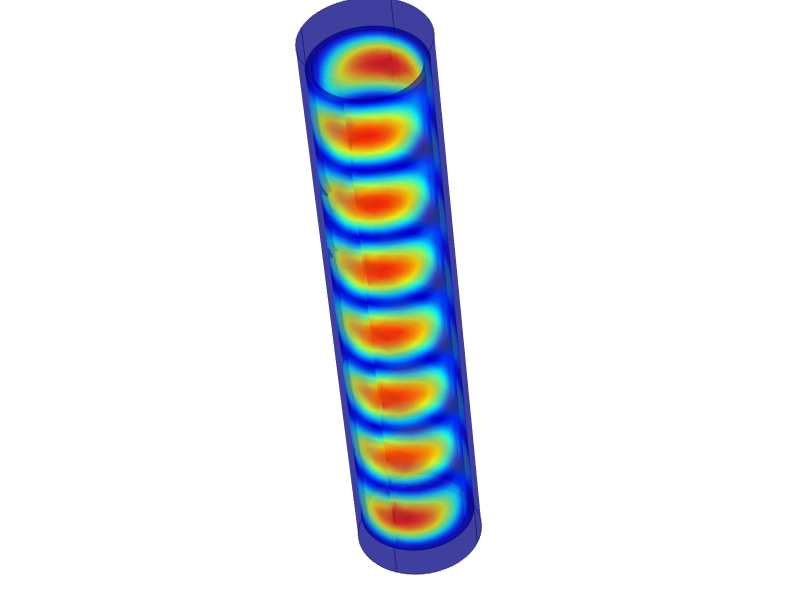

Hey again, so I'm still having some issue
I was able to get modes by adding a scattering boundary conditions and an incident plane wave, like I said earlier and I got modes like shown in the image
But I can no longer get the same modes by running the same file, but I cant tell what/if anything's changed

I suspect that is realted to your (original) model build-up and the mesh density, your glass tube is hanging in free space with an air region that is also a cavity (no PML's) and you are looking at very high order modes so I wounder if these are not coupling almost randomly.
Then I do not understand the new model buildup: where is the PML and why remove the air in the middle ?
are you modelling an infintely long glass tube or just a limited one ?, in the first case you can use periodic boundaries to make it "infinite long"
then to remove the "orange" unit issues in your field equation use rather
cos(y[1/um]*pi/1.55)
or
cos( (y*pi/(1.55[um]))[1/m] )
One more thing, are you sure you have a fine enough mesh ? to resolve your wavelength corectly you need at least 7-10 elements per wavelength (also in the glass)
