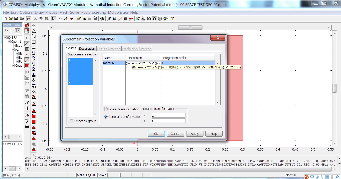

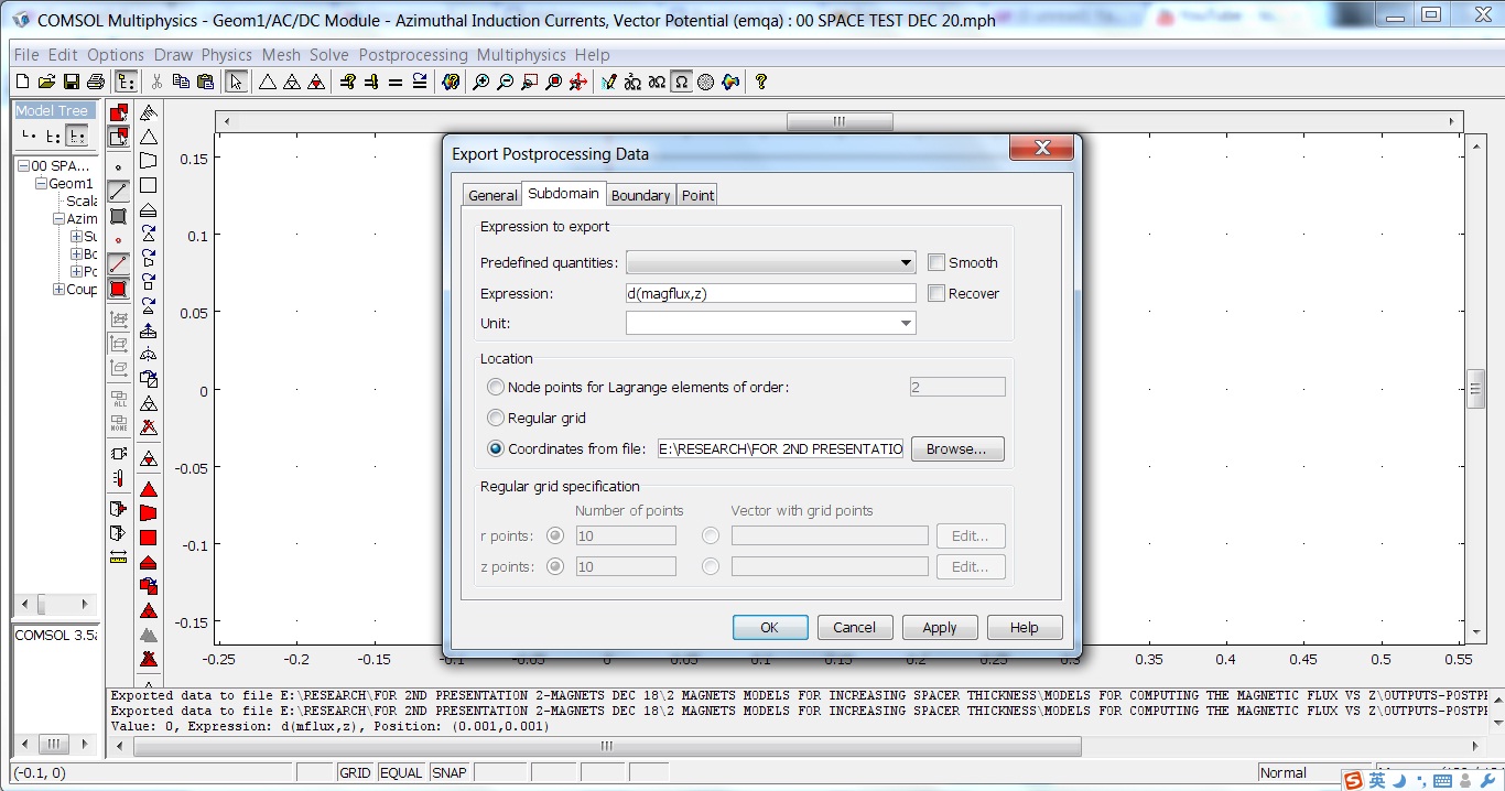

I defined a PROJECTION COUPLING VARIABLE named magflux (magnetic flux) and I exported the values of this variable vs a range of z coordinate values successfully but, when I try to export the data of the derivative of magflux (my PROJECTION COUPLING VARIABLE) with respect to z, all the values I get are equal to zero.
I have tried doing
1. magfluxz
2. magflux,z
3.diff(magflux, z)
4.d(magflux, z)
5.pd (magflux, z)
and any of these worked out. I also tried to do, just to test, pd(normB_emqa,z) and all the values are zero.
Can somebody tell me what am I doing wrong?

2. I needed the magnetic flux through the area perpendicular to the cylindrical permanent magnet, up to the outer border of the single coil loop, so I defined a PROJECTION COUPLING VARIABLE called magflux (magnetic flux) which is defined as
magflux: (Bz_emqa*2*pi*r)*((r>=0)&&(r<=7.25E-3)&&(z>=-21E-3)&&(z<=21E-3))
I did the integrations over r direction, and I made these results available in ALL DOMAINS. Then I exported these results and made a plot in excel of magflux vs z.
3.Now, I am trying to make a plot of d(magfux)/dz vs z (the first derivative of my variable magflux with respect to z) vs z. But I have tried everything and always, when I export the data, I get only zeros as the value of the first derivative.

I also tried defining a extrusion coupling variable name dmagflux, defined by d(magflux,z) and made it available in all the domains, but when in the EXPORT POSTPROCESSING DATA>SUBDOMAIN> EXPRESSION FIELD I write dmagflux when I export the data only zeros appear in the column of the derivative data, the same if I write there d(magflux,z), and also if I try to do it manually in the POSTPROCESSING>DATA DISPLAY>SUBDOMAIN field.
In the export postprocessing data I am selecting the solution corresponding to 0 seconds, because I am doing nothing with time at this moment so I think time has no effect on my problem, and if I don't do it in the exported data document appear lots of times and I only need the value vs z!
Can you please help me and tell me what am doing wrong?
