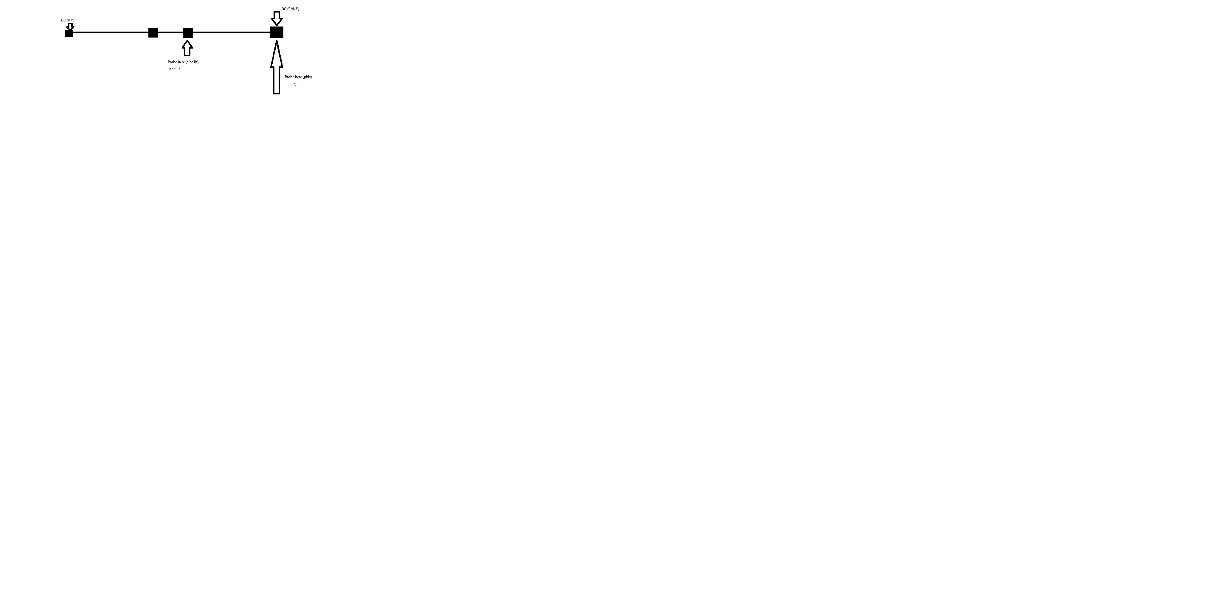

1) x_axis ----- average current density measured with a probe on the boundary (pay attention because you can set the siec.llz ,if I rember well, with the electrolyte but generally for an electrochemical system the average current density at the electrolyte interface is different from that measured at the electrode surface as Goodenough teach). Try yourself.
2)y_axis ------ here obviously you will have Vcell (phis). NOT phil.

Sorry I can't open because it was created with a new version.
Open the file where I draw in Paint a conceptual scheme where you should place your probes.
Sorry I can't open because it was created with a new version. Open the file where I draw in Paint a conceptual scheme where you should place your probes.
Posted: 9 years ago 2016年9月23日 GMT+2 12:19
