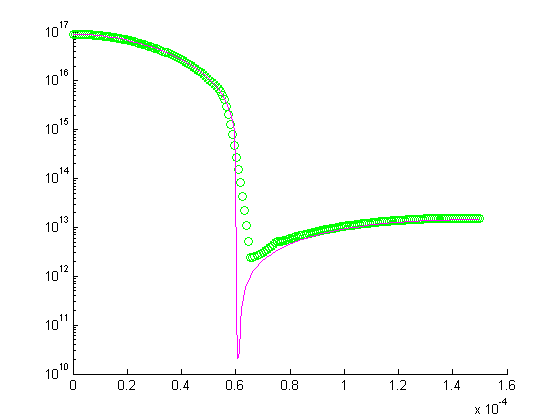

i can solve my semiconductor model with a relatively coarse mesh.
However the found solution is not good enough. It shows some
differences to a reference (PC1D) semiconductor model.
That is why i want to refine the mesh.

The Comsol solution is represented by green circles and the reference solution is shown as line in the attached figure.
