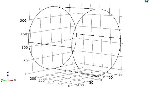

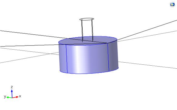

Hi! I'm new with comsol and I have a simple question: How can I connect the coaxial cable in figure with the resonator cavity?

I don't see a coaxial cable in either of your images.
However in general- the ways to couple a coaxial cable to a cylindrical cavity can be found in one of the standard texts, for example, Ramo Whinnery and van Duzer. Often a short extension of the coaxial cable center conductor is inserted into the cavity.
In Comsol you probably need to put a port at the other end of the coaxial cable and then extract S parameters or impedance after doing the EM field calculation.
DW Greve
I don't see a coaxial cable in either of your images. However in general- the ways to couple a coaxial cable to a cylindrical cavity can be found in one of the standard texts, for example, Ramo Whinnery and van Duzer. Often a short extension of the coaxial cable center conductor is inserted into the cavity. In Comsol you probably need to put a port at the other end of the coaxial cable and then extract S parameters or impedance after doing the EM field calculation. DW Greve
