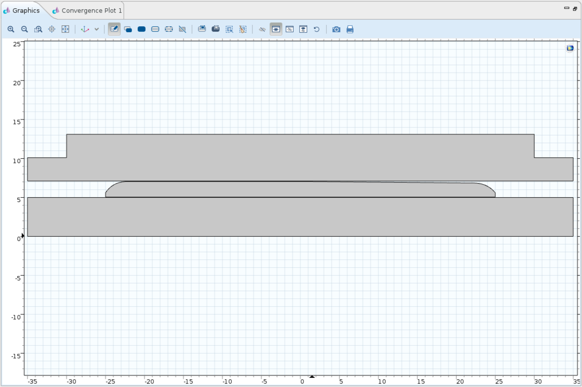

In the geometry you can see that there is a small gap between them on the right half of the polymer. When the top plate is pressed down the polymer-regions that are not in contact can expand to the sides. When the top plate is pressed down even more, I want the polymer to be glued to the top plate in the respective positions.

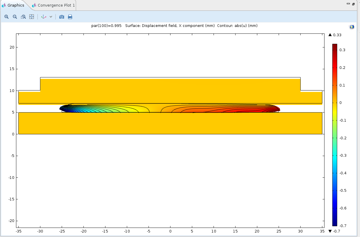

When I work with a thin elastic layer, the region of the polymer that comes into contact is pulled back to its initial x-coordinate and not fixed at the x-coordinate where the parts come into contact as you can see in the second picture where the displacement in x-direction is displayed.
