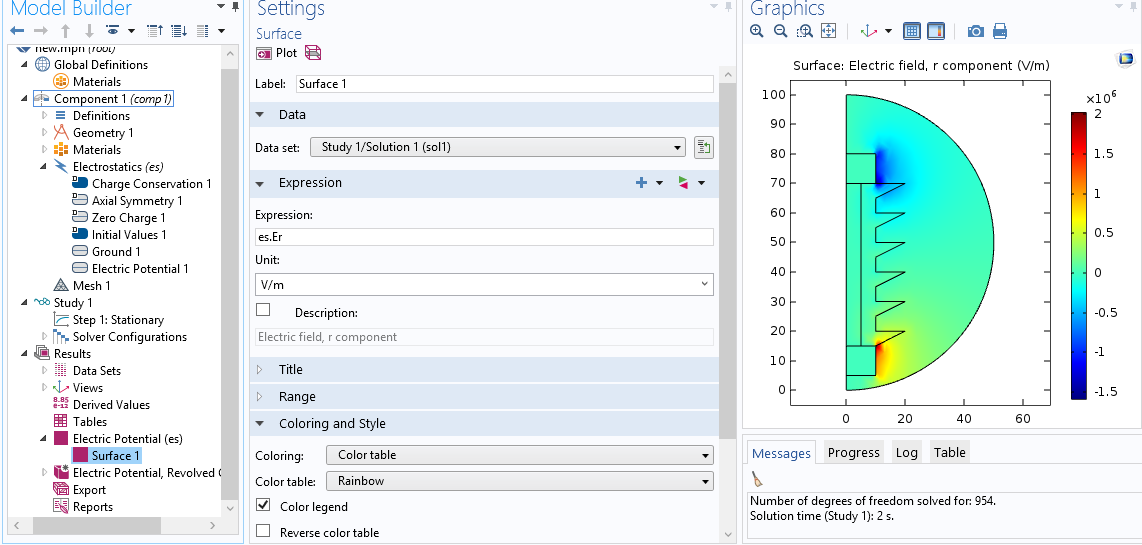

i am using 2D drawing. i have already done a simulation using the equation es.Er is this equation correct.

es.Er is the radial component of the electric field in an axisymmetric analysis like yours.
If I misunderstood your question, please alaborate on what your concern is.
Hello Azidh, es.Er is the radial component of the electric field in an axisymmetric analysis like yours. If I misunderstood your question, please alaborate on what your concern is. Best, Jeff

i am investigating effects of electric distribution around silicon rubber insulator in clean and polluted area.
the simulation result i posted was with clean area. As seen in the results electric filed is high only in side of the insulator. so my question is this result is correct or not?
i am investigating effects of electric distribution around silicon rubber insulator in clean and polluted area. the simulation result i posted was with clean area. As seen in the results electric filed is high only in side of the insulator. so my question is this result is correct or not?
