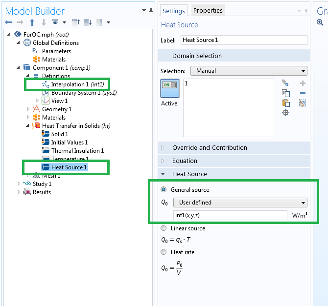

Hi Jeff, Thanks for your help and apologies again for asking.
My question is I do not know how to call the int function that is in position 1. This int function is the heat generated. But in heat transfer, what can I do to call the function in the heat source (Q)?
Now I do not know how to call the x, y, z coordinates. I do not know if it can be explained me with an image or an example. Thank you very much and sorry again.

Posted: 8 years ago 2017年3月31日 GMT+2 14:27
See the attached screenshot.

Hello Jeff.
Thanks for your help. I was missing the units. In Heat Source it is int1 (x [1 / cm], and [1 / cm], z [1 / cm]). This was my mistake. But thanks to you, you were a great help.
