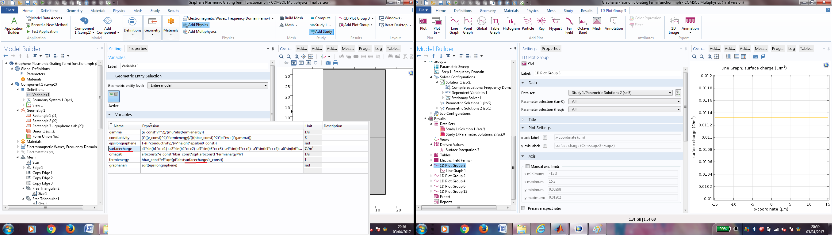

Hi! I'm using comsol 5.2a. I've found a function for results from another comsol file, and I'd like to use that function to describe it in another file in order to save file size and computational time.
I've defined it as a variable with lots of parameters associated, as shown in the screenshot. I went to check that it was working correctly but unfortunately comsol believes the function is actually a constant - the value of the function at it's maximum (x=0). What's going on here?
Thanks!

That's weird. These are things that I would do:
1) Check the values of a1, a2, a3, ...to make sure they are non-zero.
2) Make sure you have plotted your defined variable "surfacecharge" not anything else defined
3) Check the units of b1, b2, b3, b4, ... and see if the products of bi*x in the parentheses are comparable to ci. If not, you should expect a constant function rather than a sine function.
I think (3) is probably the issue.

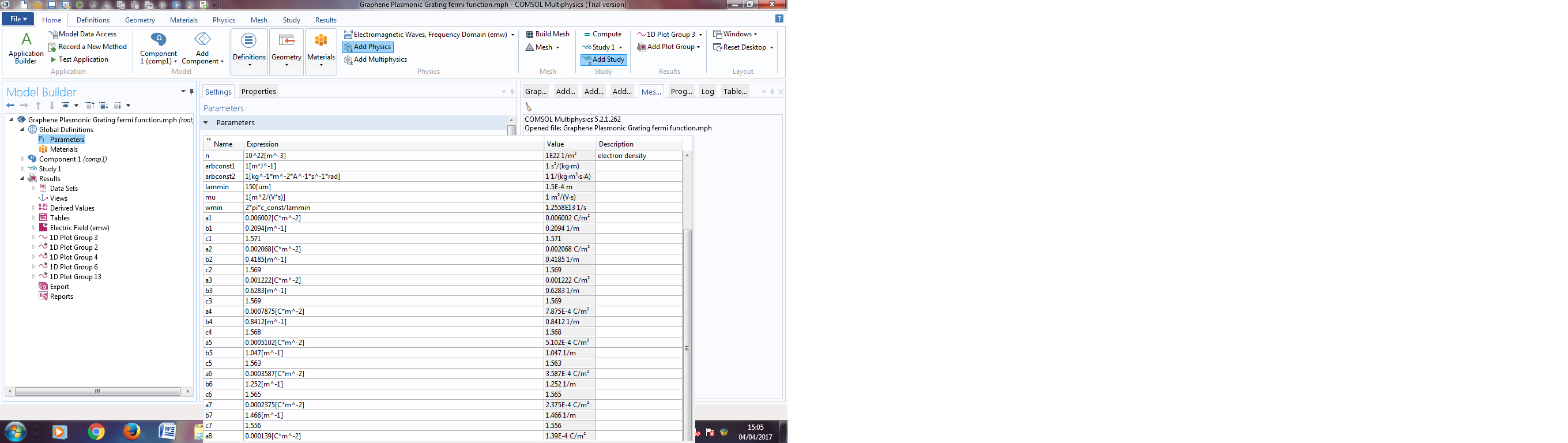

Hi Mohammad, thanks for the response. I've screencapped the relevent part of the parameters list for you in parameters.png. The parameters are non-zero. The a parameters have units of surface charge density, the b parameters have inverse spatial units so to cancel b*x to be unitless, which is compatible with the c parameters which are also unitless.
I also changed the variable to "surfacechargerrr" with the plot also changed, just in case comsol reserves the string "surfacecharge", but it still displays the same thing.

I'd be happy to help you. But, no need to send your file. Just look at the terms in the sine function. They are not in the same order of magnitude. Therefore, the sine functions are almost constant and do not vary with variable x.
For instance, lets look at sin(b1x+c1):
b1x=0.2094[1/m]*15*1e-6[m]=0.00000314
while c1=1.571
Thus:
sin(b1x+c1)~sin(c1)
sin(b2x+c2)~sin(c2)
sin(b3x+c3)~sin(c3)
sin(b4x+c4)~sin(c4)
Try to change the units of b1, b2, b3, ... to micrometers and see the difference.
Amin,
Jashua I'd be happy to help you. But, no need to send your file. Just look at the terms in the sine function. They are not in the same order of magnitude. Therefore, the sine functions are almost constant and do not vary with variable x. For instance, lets look at sin(b1x+c1): b1x=0.2094[1/m]*15*1e-6[m]=0.00000314 while c1=1.571 Thus: sin(b1x+c1)~sin(c1) sin(b2x+c2)~sin(c2) sin(b3x+c3)~sin(c3) sin(b4x+c4)~sin(c4) ... Try to change the units of b1, b2, b3, ... to micrometers and see the difference. Amin,
Posted: 9 years ago 2017年4月5日 GMT+2 17:49
Perfect, that fixed it. I changed the units from micrometres to metres and b*x became comparable to c. Matlab was able to render the tiny variation but Comsol was not so I guess there is a decimal difference there or something.
