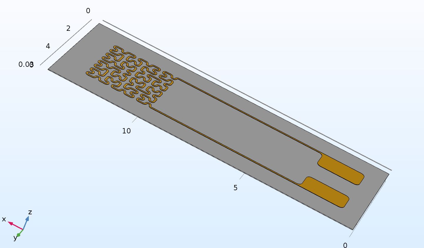

Dear Sergei,
Many thanks for your answer! I am trying to get a swept mesh to work for my 3D geometry. I'm having difficulties at the interface between the two layers due to the complexity of the geometry. I have managed to get a swept geometry for the resistance part on top. Do you know how I could get the mesh to work at the interface of the two? I'm attaching an image of my geometry.
Thank you very much,
Amanda

Amanda,
Attached is thin layer geometry with Swept mesh. You can control layer thickness using global parameter t_layer.
Are you sure that thin layer should be modeled as a solid domain? If the thickness of the layer is small then you can model it as a shell - look at the model example
www.comsol.com/model/heating-circuit-465
Sergei
Amanda, Attached is thin layer geometry with Swept mesh. You can control layer thickness using global parameter t_layer. Are you sure that thin layer should be modeled as a solid domain? If the thickness of the layer is small then you can model it as a shell - look at the model example https://www.comsol.com/model/heating-circuit-465 Regards, Sergei

Dear Sergei,
Thank you very much for the file with the example swept mesh, it was extremely helpful! I am now comparing a shell model with a swept model. I think the shell model might be better as you suggested.
Thank you!
Amanda
