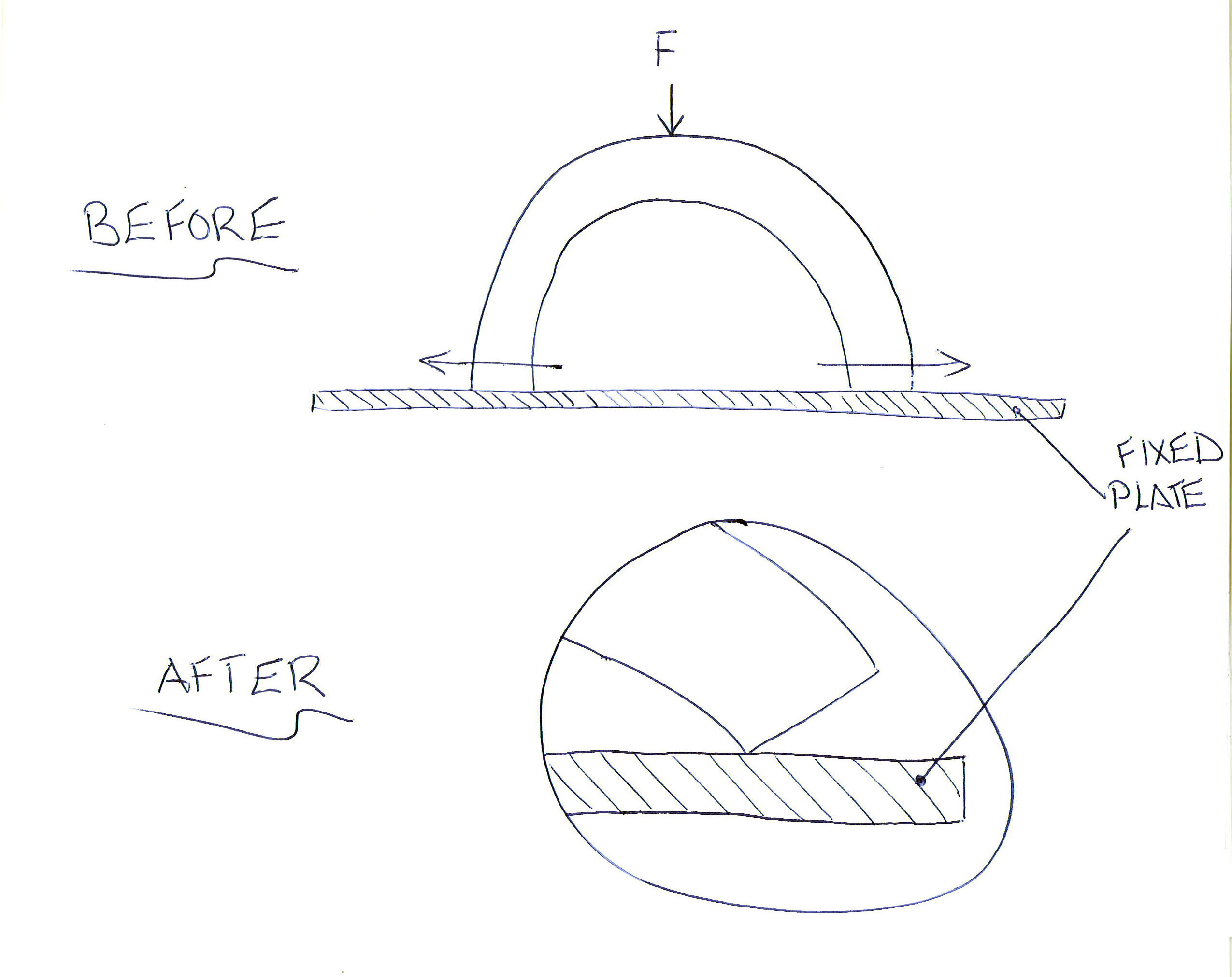

I'm trying to simulate the effect of a load pressing down on an arch-shape (made of composites with cylindrical orthogonal material properties). This arch is resting on a fix rigid plate but the arch is free to slide open when pressed down.
(See ArchSchematic.jpg)
With the load pressing down, the arch will "open" and its extremities will raise. The only contact remaining with the plate being a single point.
Try #1 (See OrthogonalArc8.mph)
I tried to simulate that by creating a contact between the arch and the plate (Contact Pair > Contact) but I end end with a Segregated Solver Steps error ("segregated solver steps do not involve all components").
I tried to replicate some settings of the model example "cylinder_roller_contact.mph" in the model library and this time I end up with a Jacobian error ("Failed to evaluate operator Jacobian").

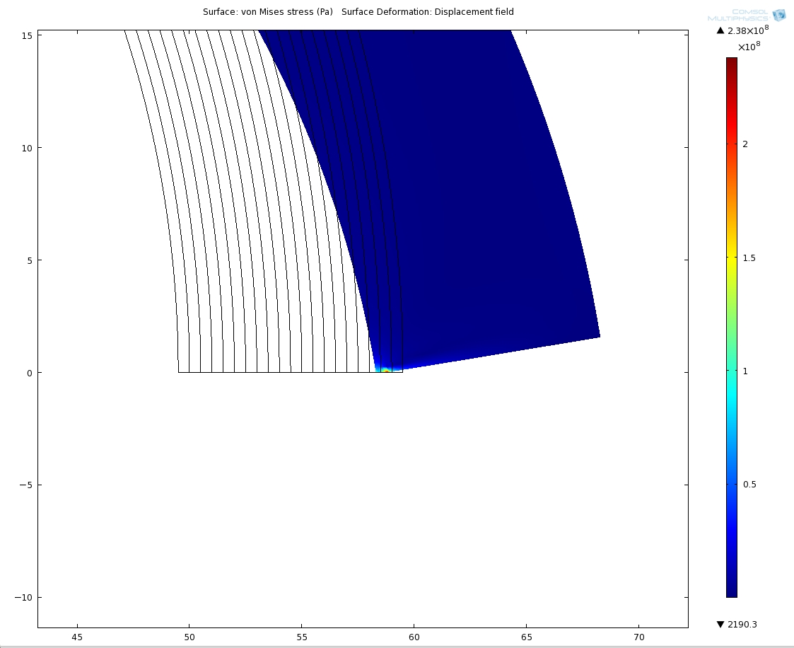

Instead of working with contacts, I decided to use the ROLLER constraint. But since the roller constraint does not exist for a single point, I had to apply it on a small edge of my model which provoked a stress discontinuity.
(See PointStress,jpg)
I wouldn't mind that discontinuity if I was able to create a subset of the result and remove a couple of mesh cells for visualization purpose so that the scale factor would not be effected by it and I would be able to actually see the stress in the model (not just all blue).
So finally my question is: Is there a way to create a "Point-Roller" constraint OR a way to remove from visualization of stress some area of the model where we know that there are some mathematical artifacts?

if your "ground" is horizontal, I would say that your "point roller" constraint is essentially prescribed displacement y=0, no restrictions on x (in 2D) for the point. Or what do you believe?
To avoid to display high or low stress values you can always "filter" part of the images out, in v4.1 you have a filter sub-node, and also the rulers for the min-max display values in the plot section.
In 3.5 we ususally added a bolean conditions
(1E5 < smsld.mises) * smsld.mises * (smsld.mises < 1E6)
Hi if your "ground" is horizontal, I would say that your "point roller" constraint is essentially prescribed displacement y=0, no restrictions on x (in 2D) for the point. Or what do you believe? To avoid to display high or low stress values you can always "filter" part of the images out, in v4.1 you have a filter sub-node, and also the rulers for the min-max display values in the plot section. In 3.5 we ususally added a bolean conditions (1E5 < smsld.mises) * smsld.mises * (smsld.mises < 1E6) -- Good luck Ivar
