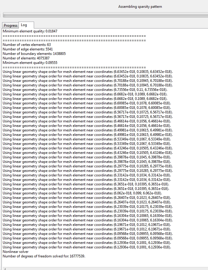

Thanks for the input. I guess you are right since my 3D model has 4,000,000 elements.
(see Log in attachment)

16 millions DoF? Is incredibly big, you should definitely try to reduce it. Seriously... It will take weeks to solve alredy in a "normal" way, with the swapping of data even more. I don't think you will ever get a solution with that model.

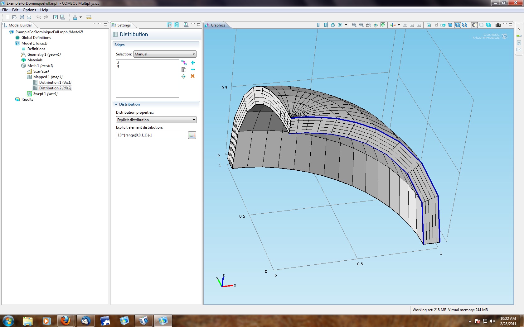

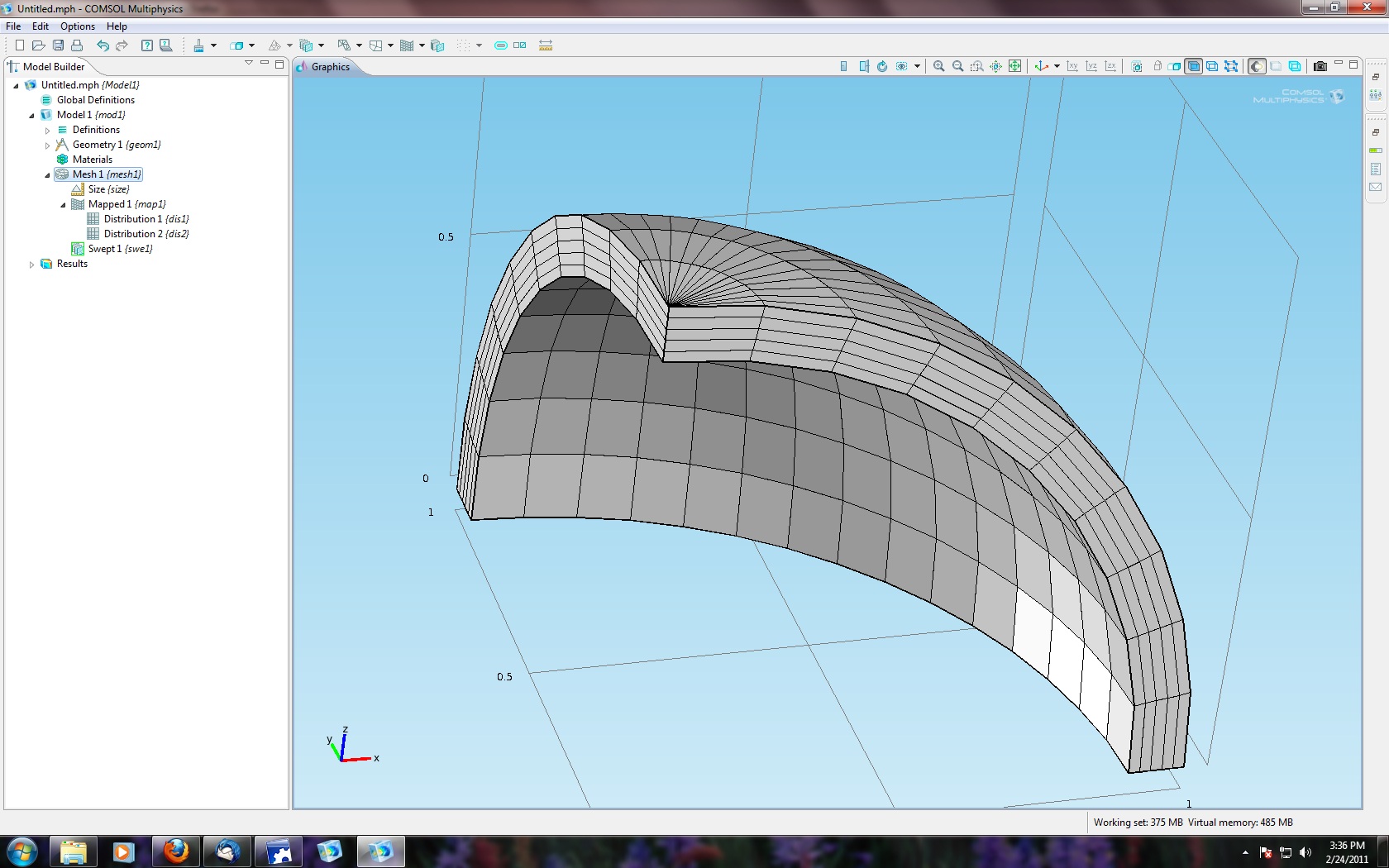

I am not sure how you mesh that hollow half sphere, but I can't see how you would not be able to reduce the number of elements much further. In the attached screenshot, a quarter of one ply of your structure is meshed with 750 elements (and you could use a coarser mesh in the theta direction), while using 5 elements through the thickness of the ply, which should be plenty. That's 3,000 elements per ply for the entire structure. I can't imagine that you have 300+ plies.
What am I missing?
Hello Dominique, I am not sure how you mesh that hollow half sphere, but I can't see how you would not be able to reduce the number of elements much further. In the attached screenshot, a quarter of one ply of your structure is meshed with 750 elements (and you could use a coarser mesh in the theta direction), while using 5 elements through the thickness of the ply, which should be plenty. That's 3,000 elements per ply for the entire structure. I can't imagine that you have 300+ plies. What am I missing? Jeff

I'm having difficulties to use the Swept mesh since my surface has only 3 edges and not 4. How did you achieve a swept with edges having a mapped mesh without the need of converting it to triangles?
Also, doesn't the top portion of the mesh with very elongated triangles (high aspect ratio and high skewness) could cause problem in the solving process? I've always thought that a good mesh needed to have more or less compact elements?
(Even at 1 million elements, I get a "Out of Memory LU" error...)

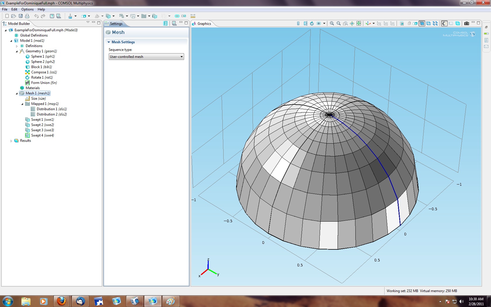

Dominique,
The same meshing approach carries over to your hollow half sphere. This is done in the attached file. Notice that I built the geometry by patching together four quarters of the geometry. This introduces internal boundaries that are used for meshing.
Regarding your second question: you can use the Distribution nodes to control the distribution of your mesh; this gives you complete freedom over your mesh distribution. The attached screenshots show this.
Dominique, The same meshing approach carries over to your hollow half sphere. This is done in the attached file. Notice that I built the geometry by patching together four quarters of the geometry. This introduces internal boundaries that are used for meshing. Regarding your second question: you can use the Distribution nodes to control the distribution of your mesh; this gives you complete freedom over your mesh distribution. The attached screenshots show this. Jeff

Thanks Jeff.
The problem I encounter is that I cannot make a circular sweep, I always get the following error:
"Sweep path 'circular' is not supported on this geometry".
(It's able to start a sweep when I use the straight line option but it gives a very bad sweep which does not follow my geometry at all).
I find that weird since my geometry is based on a sphere with layers. Could it be that new "layer" option that is problematic?
Or could it be the Boolean operations I used to create a fourth of an empty sphere?
Here is my model included.
If you could point me out in the right direction it would be really appreciated.
Thanks,
Dominique
Thanks Jeff. The problem I encounter is that I cannot make a circular sweep, I always get the following error: "Sweep path 'circular' is not supported on this geometry". (It's able to start a sweep when I use the straight line option but it gives a very bad sweep which does not follow my geometry at all). I find that weird since my geometry is based on a sphere with layers. Could it be that new "layer" option that is problematic? Or could it be the Boolean operations I used to create a fourth of an empty sphere? Here is my model included. If you could point me out in the right direction it would be really appreciated. Thanks, Dominique
