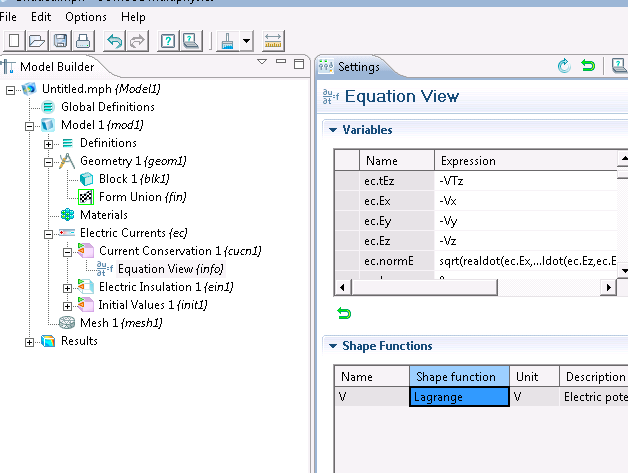

you are perfectly right ec.Ex = -Vx the gradient of the voltage, that's the danger of using a convention and then violate it with exceptions at the first occasion :)
There are so many physics and each have its exceptions, COMSOL could have chosen a more systematic convention here and avoid exceptions, I hope thy weould be more systematic, it's already tough with all their implicit indexes and meanings ;).
i.e. "_x" for derivatives and "x" simple suffix for components hence we would have ec.Ex_x = -V_x_x
But once started with such things it's difficult to change later, V4 could have been used for that too. Hopefully thex will write out again the full list of variables as they had for 3.5a
Still my comment remains Ex i defined from a gradient hence is somewhat noisy whcih could (but not necesarily be enough) to give you solver or Jacobian derivative issues

obviously it's getting late for me and I need to dig into the doc again, and we are slightly missing each other for the understanding I believe ;)
But, I even did a quick check before writing my previously response, looking at the equations under the EC/ES modules (see png) :(
and ec.normE = sqrt( realdot(Ex,Ex)^2 + realdot(Ey,Ey)^2 + realdot(Ez,Ez)^2 )
realdot() is there since Ex,y,z might be complex, as you square the variables for the norm you might get some bifurcation issues with the solver indeed
Note in the magnetic MF we have Ex = Axt or d(Ax)/dt or for MEF a combination of both EC and MF
The difference might come from the "curl" and "Lagrangian" shape elements used respectively for solving A and V as dependent variables
again note the notation:
Ax is the x component of vector A, while Vx is the x derivative of the scalar V
Axx is the x derivative of Ax the vector x component, while Vxx is the second derivative of scalar V
