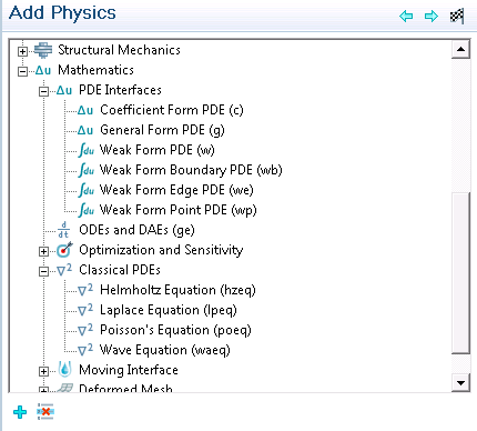

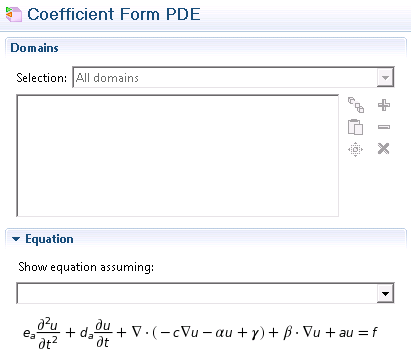

Check the list of Math physics, basically the PDE of the coefficient form entering the shape given hereafter are solved, so long we talk about well defined BVP. The all terms might be analytical functions not just constants, which often leads to non linear problems. Higher order equations must be preprocessed manually to get down to 2nd order by a adding a few new intermediate variables.
Check with your local rep to follow one of the training courses, or the free workshops
Hi Check the list of Math physics, basically the PDE of the coefficient form entering the shape given hereafter are solved, so long we talk about well defined BVP. The all terms might be analytical functions not just constants, which often leads to non linear problems. Higher order equations must be preprocessed manually to get down to 2nd order by a adding a few new intermediate variables. Check with your local rep to follow one of the training courses, or the free workshops -- Good luck Ivar

It appears that an user can enter his own equations
through general template equations by acting on the
coefficients.
Also in the webinar, a slide mentions the possibility
to enter a PDE in weak form.
This is exactly what I am interested in.
In that case do we use some kind of template models ?
Is it possible to have an exhaustive list of the
available operator ? Is there a example available ?
