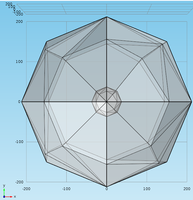

When using a geometric order greater than 1, are the nodes, that are not located at the vertices and thus not displayed located at the boundary of the discretized body?
Please find attached a picture of the illustration, that appears when I use the options "automatic" or "Quadratic" in the field "Geometry shape order" and the option "Quadratic" in the field Discretization => Temperature.
I am trying to discretize a hollow sphere. Shouldn't the elements next to the boundary be a little bit more round? Otherwise there would be, as far as I know, an unneccessary geometric discretization error. Or is the curvature just not displayed?
Thanks!
Greetings
Daniel
Hello, thanks for the quick answers. When using a geometric order greater than 1, are the nodes, that are not located at the vertices and thus not displayed located at the boundary of the discretized body? Please find attached a picture of the illustration, that appears when I use the options "automatic" or "Quadratic" in the field "Geometry shape order" and the option "Quadratic" in the field Discretization => Temperature. I am trying to discretize a hollow sphere. Shouldn't the elements next to the boundary be a little bit more round? Otherwise there would be, as far as I know, an unneccessary geometric discretization error. Or is the curvature just not displayed? Thanks! Greetings Daniel
Posted: 8 years ago 2017年7月18日 GMT+2 17:47
The curvature is not displayed.
The curvature is not displayed. Jeff
