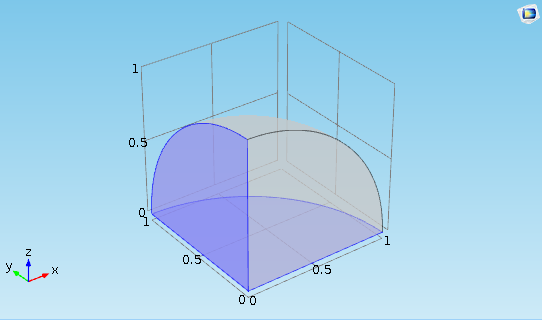

Now, I want to solve for the electric potential inside the whole sphere. Because of the obvious (anti)symmetry, it is tempting to split the simulation domain and consider only one quadrant of the whole geometry (keep in mind that I would like to use these principles in solving more complex but still (anti)symmetrical models). Is it possible to impose an antisymmetry condition to the highlighted faces (antisymmetry_faces.png)?
[https://imgur.com/a/127Kl]
I found out that in some physics interfaces, this is possible (e.g., the Perfect Magnetic Conductor Boundary Condition). But is it possible in electric currents or electrostatics interface?
