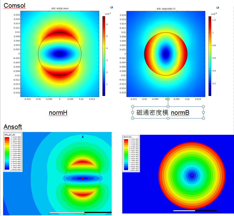

I want to simulate a simple model of a copper wire with dc current, and I want to look how the magnetic field looks like in the wire when the perneability is anisotropic such as mu_x=1; mu_y=2; mu_z=1. The model I used was 2D with a small circle for the cross section of the wire and a much bigger circle for the air section. The results seems odd because the B seems like anisotropic(an ellipse) while the H is also anisotropic.
And I tried to do the same thing in Ansoft and it turned out different results: The H is still anisotropic but B is isotropic (a perfect circle in other words).
I think there should be only one correct result if all the modeling steps were the same, so which one is wrong?
