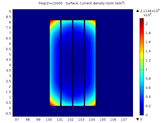

Hallo, I am trying to model and simulate a stranded conductor (4 Strands) with rectangular cross-section and the model is built 2D axisymmetric.
As excitation, I have define a single turn coil (option coil group not choosen) and gave it to all 4 strands. However, the result is not like I expected.

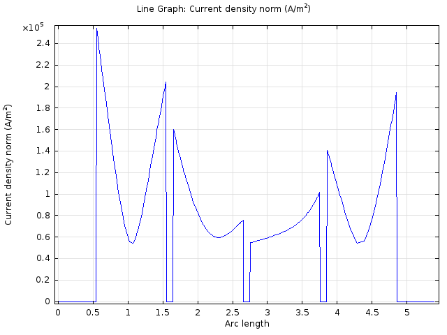

Can anyone tell me whether this current distribution is correct? The line graph is the current density on the line which is drawn through the middle of the conductor.
