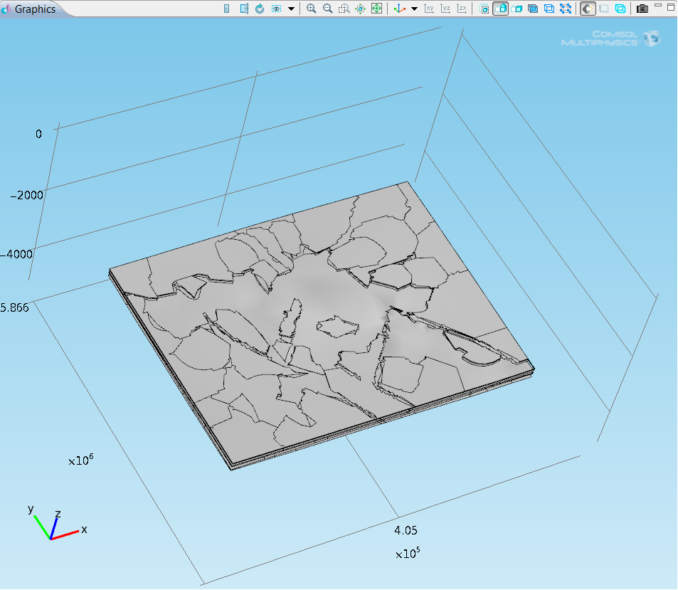

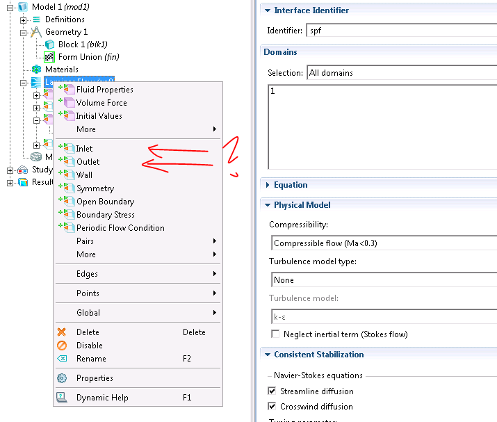

Thanks a lot for your point of view, I hereby attach my 3D geometry model, at which I have 7 geological layers that I would like to assign one of the 4 edges as inlet, for each of them. I did check out laminar flow\inlet before, but I gona put in more efforts on that again :)
Appreciate if you do have some insight. Many thanks!!
