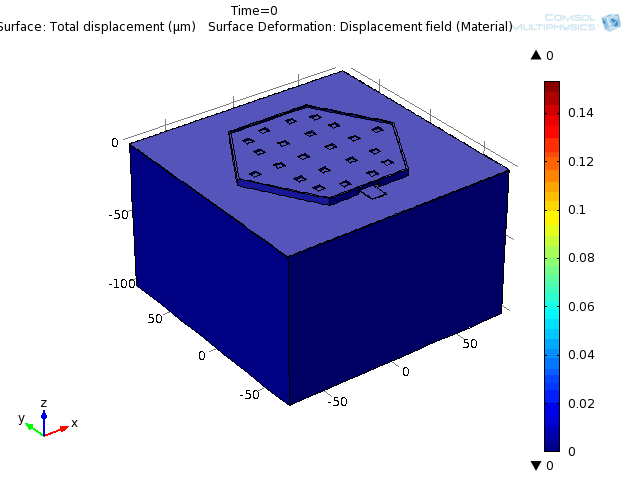

I am trying similar problem. What I am trying to do a structural mechanics simulation on a capacitive sensor to simulate a vibration and then find the capacitance change with respect to vibration. It means I am doing a vibration simulation and then a electrostatics simulation to find the capacitance change. Is it possible in COMSOL?
Thanks

if you use an eigenmode solver your amplitudes are not "real" so the capacitance value will not be real either.
I would rather deform the structure with a parametric Force or pressure value and with a stationary solver.

Thanks for the answer. I am using a time dependent simulation. I have created the vibration with a "prescribed displacement"(at structural mechanics module). But after that I need to find the capacitance simulation. I need to find the capacitance each time.I am attaching a file that will explain what I have done yet.

Well either you calculate the capacity with the ACDC module physics by using the calculated field, or you calculate / integrate the average distance versus area to get the capacity of a plane paralle plate
Both, in your case, should give similar results (5-10%), at least from my understanding of your model (but I might be wrong as "just" an image is not really enough to understand all the subtilities ;)

Thanks for the information. you have written that "Well either you calculate the capacity with the ACDC module physics by using the calculated field"-Thats right I also wanted to do that, but i dont know how I can do that . I have tutorial that computes the static capacitance but not the capacitances which will change with time.I also do not know how I can do multiple step simulation.
