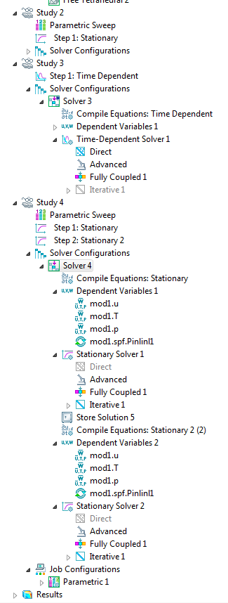

first a few comments,
1) your HT fluid region you can select Velocity field "spf/fp1" instead of user defined, not that it should changee anything the way you have done it
2) your study 3 stationary, in the "Values of dependent variables" you shoul select it and refer to the first study, then you do not need to go into the details of all the dependent variables of study 3
3) as you ahve a parametric study in case 1, and just a time series, I do not beleive COMSOl proposes to do a mix, but will take only the first result from study 1, two ways around : 1) add a parametric for study 3 and hope COMSOl understands (I havent checked if this is truely the case, just a guess, 2) my preferrenec, set up one new study with the parametric sweep frist, then two stationary solver in sequence under the same "study", one after the other, the frist for the fluid, the second for HT. COMSOl will then make a "store solution to transfer the dependent variables not solved for from one to the next case
then generate the default solvers, you should get something like this (see image)
