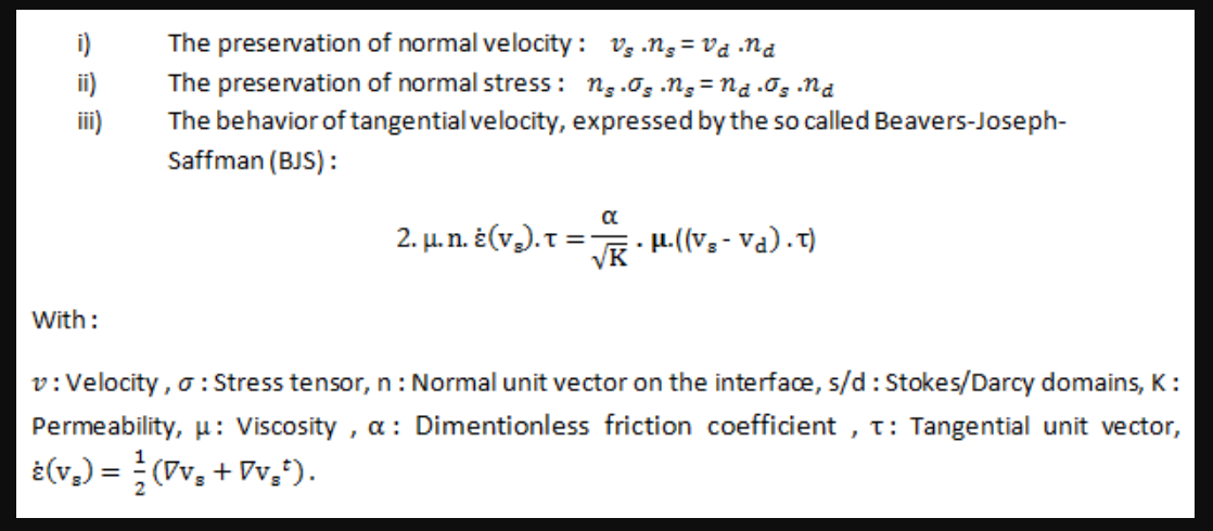

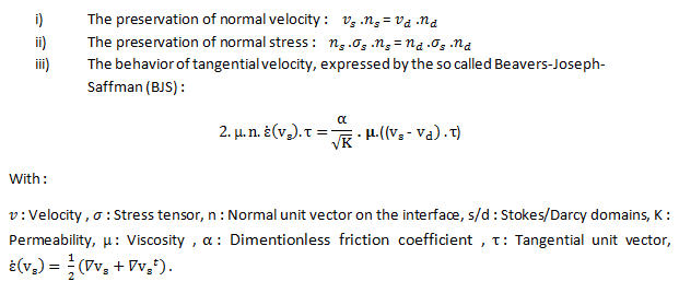

Working on Stokes-Darcy coupling of a simple 2D geometry; two rectanglar domains where the liquid flows first in the Stokes domain then penetrates into Darcy’s through the interface.
The three interface conditions are shown in the image attached (velocity, stress and BJS).
How to typically introduce these conditions in COMSOL in order to well define flow through the interface ?
Any help would be greatly appreciated.
