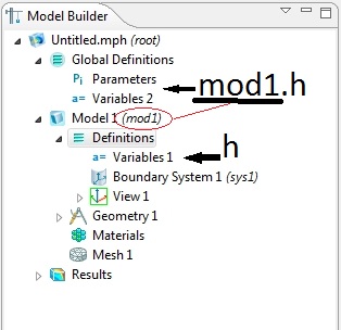

If you have defined your variable or your parameter under Global Definitions, you have to type the Model Identifier before h (mod1.h).
If you have defined h under Model 1, then I don't know what to tell you.
look at the attached jpg.
Salut Naveed If you have defined your variable or your parameter under Global Definitions, you have to type the Model Identifier before h (mod1.h). If you have defined h under Model 1, then I don't know what to tell you. look at the attached jpg.

Thank you very much! Yes, it was missing "mod1". I have never done this in COMSOL 3.5a, so a new thing to learn.
