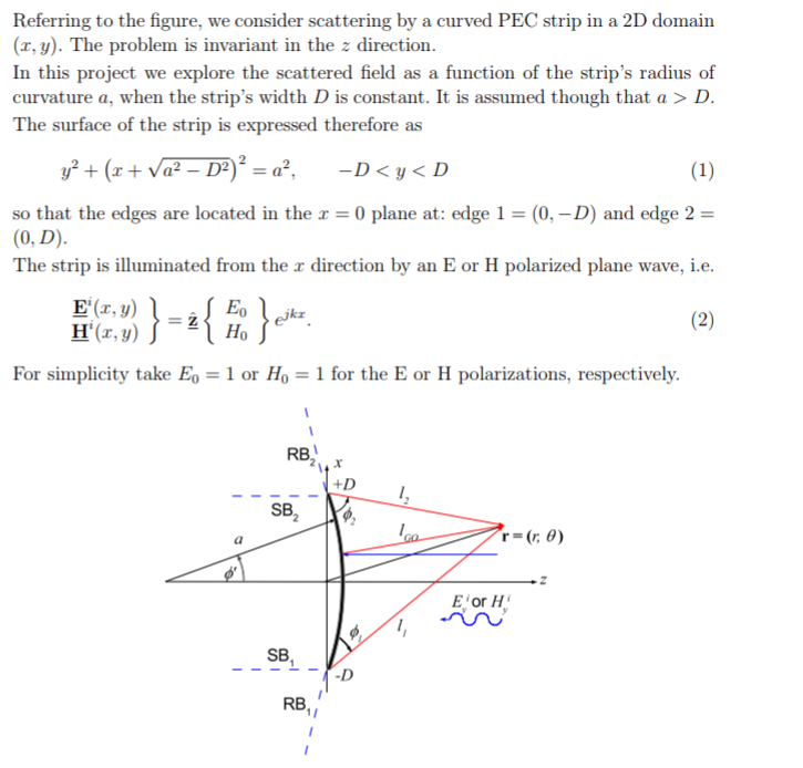

Hi I need help with scattering from curved PEC, somone can help me please? Thanks

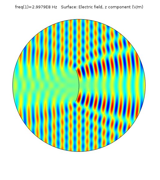

Dodi,
Attached is model for scattering disk for the out of plane polarization of the incident electric field.
Sergei
