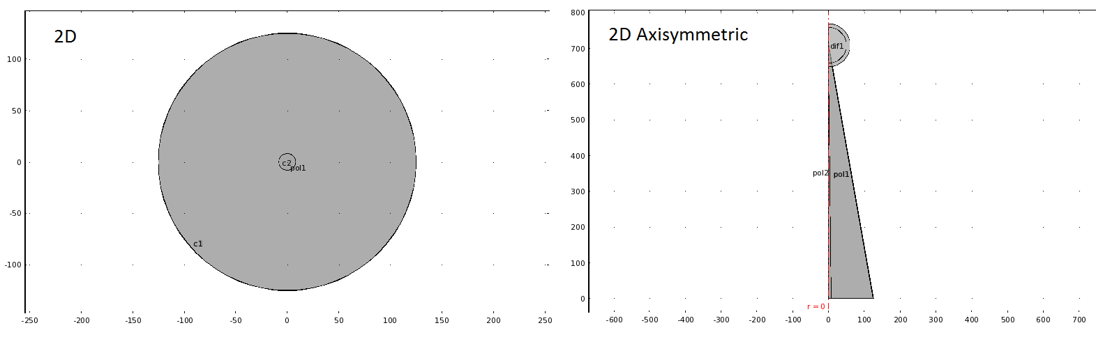

Dear Ivar,
Apologies for not phrasing the problem clearly and thanks for your fast reply! In the regular 2d case I study a circle that should have the same dimensions as the the port that I defined as a line from r=0 in the 2D axisymmetric case (if I unstand the 2D axisymmetry correcly).
Do I not correctly assume that applying a mode analysis to the regular 2D circle should yield the same effective mode index as the a boundary mode analysis to this 'line' from r=0 in the 2D axisymmetric case?
Boris
Dear Ivar, Apologies for not phrasing the problem clearly and thanks for your fast reply! In the regular 2d case I study a circle that should have the same dimensions as the the port that I defined as a line from r=0 in the 2D axisymmetric case (if I unstand the 2D axisymmetry correcly). Do I not correctly assume that applying a mode analysis to the regular 2D circle should yield the same effective mode index as the a boundary mode analysis to this 'line' from r=0 in the 2D axisymmetric case? Boris

For clarity, these are the geometries I use (in the 2D axisymmetric case my port is at z=0)

Shouldn't the 'dif' half circles on the top of your 2D-axi actually be rectangle-shaped? Because this revolves around the r=0 axis and the circular fiber profile would be created automatically...

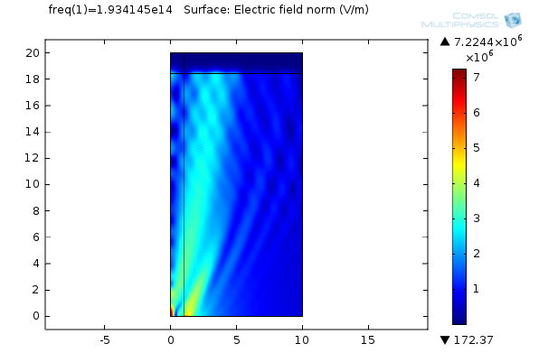

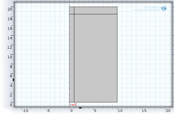

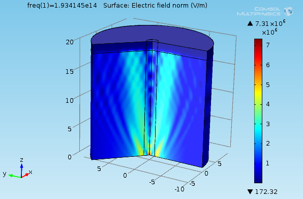

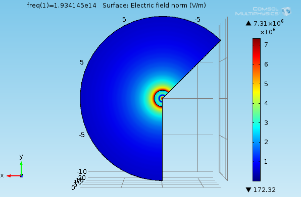

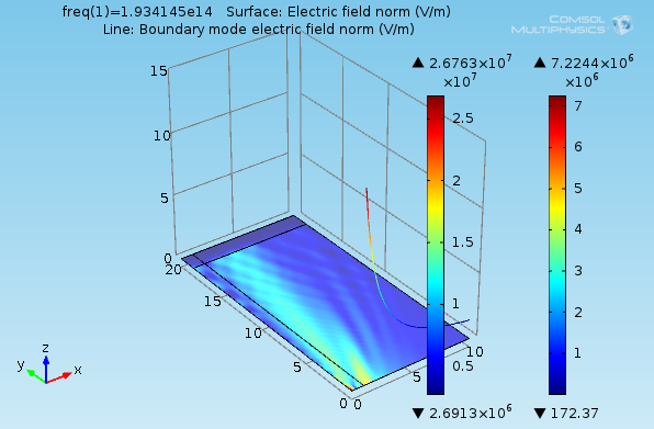

Hi! I'm a new user of Comsol. I got an evaluation trial license. I need to model a tapered fiber. So firstly, I decided to run simple examples contained in model library. I ran RF/step_index_fiber. I tried to follow the same steps contained in this example but in 2D axisymmetric and 3D model. But unfortunately I did not get the same results. In 3D model I couldn't get any distribution of electrical field. I realized that it is a common problem but anyone was able to appropriately answer those kind of questions. Is it a problem related to excitation? Thanks in advance.
