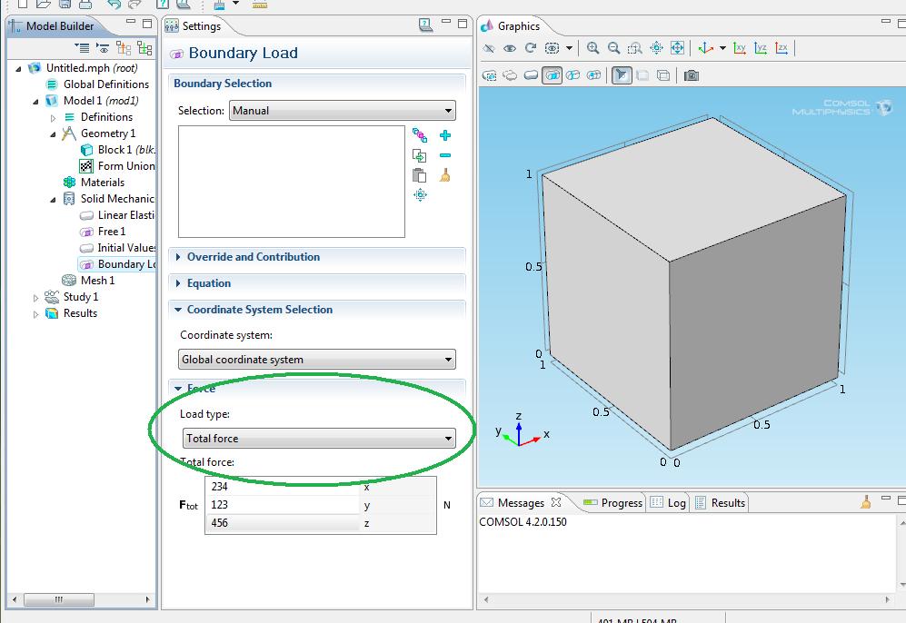

How can I input a total load on a boundary, without having to calculate the x-sectional area?
In many cases one knows the total force readily, and would simply like to impose a boundary condition of that force over that arbitrary area.

In v3.5a, you can have the software compute the surface area for you by way of an integration coupling variable. It's a bit clunky, but it works.
In v4.2, you have the option of providing the total force and the software does the rest for you, see screen shot.
