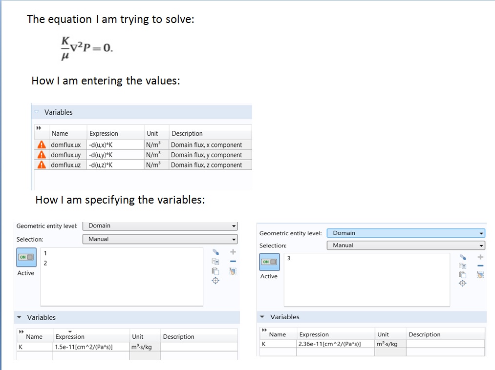

I just tried that and it doesnt seem to bring any change to the result. The left column in equation view has a warning sign inside it now. I have attached an image showing how I modified the Laplace equation. Thank you for your help

It seems that you are using the Laplace Equation interface, which really just solves . To get K into the equation, I would use the Coefficient Form PDE interface with c = K and all other coefficients set to 0. The warning sign indicates that you are changing the built-in definitions of those variables, which you can do, but you should then be aware that you affect the results. If you plot them, you can see that the K values set up as suggested in the previous reply do have an effect, but they will not affect the solution to the Laplace equation.
Best regards, Magnus Ringh, COMSOL
Hi, It seems that you are using the Laplace Equation interface, which really just solves \bigtriangleup u = 0. To get K into the equation, I would use the Coefficient Form PDE interface with c = K and all other coefficients set to 0. The warning sign indicates that you are changing the built-in definitions of those variables, which you can do, but you should then be aware that you affect the results. If you plot them, you can see that the K values set up as suggested in the previous reply do have an effect, but they will not affect the solution to the Laplace equation. Best regards, Magnus Ringh, COMSOL

Hi Magnus that worked wonderfully. Thanks!
