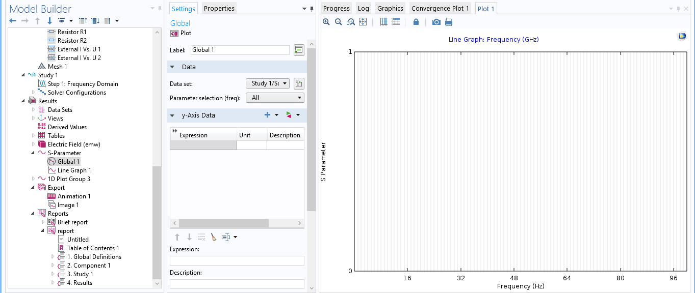

Dear Sir Edgar, How to compute the S11 parameter in coaxial cable? The calculation of S parameter did not plotted in the graph of S parameter against frequency.

There is no expression in the global plot.
