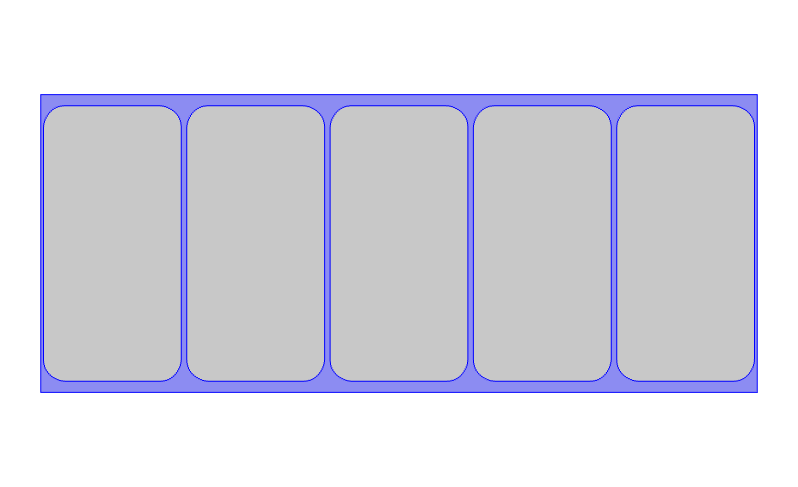

Hi, I was trying to compute the profile of molecule concentration (which is the result of certain stationary or time-dependent study) by projecting the 2D data onto a 1D axis. Like showing in the attached graph, molecules can only diffuse in the blue region and I want to look at it concentration profile in the horizontal direction (x-direction) by averaging its concentration in the vertical direction at every x location. I understand this can be done by exporting all of the data and using MATLAB to do the averaging part. But the exported data files are huge for the real geometry I am looking at. I wonder if this can be done within COMSOL? Thank you!

Hi Emily, in COMSOL Multiphysics, use the Linear Projection, or General Projection couplings.
Read up on this is the documentation (Press F1 in COMSOL to bring the doc up). Then go to the section COMSOL Multiphysics Reference Manual > Global and Local Definitions > Component Couplings and Coupling Operators.
