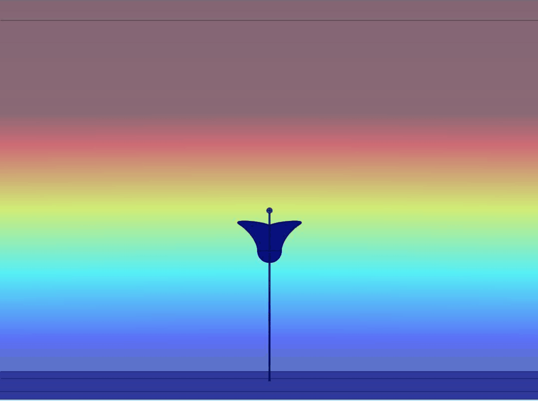

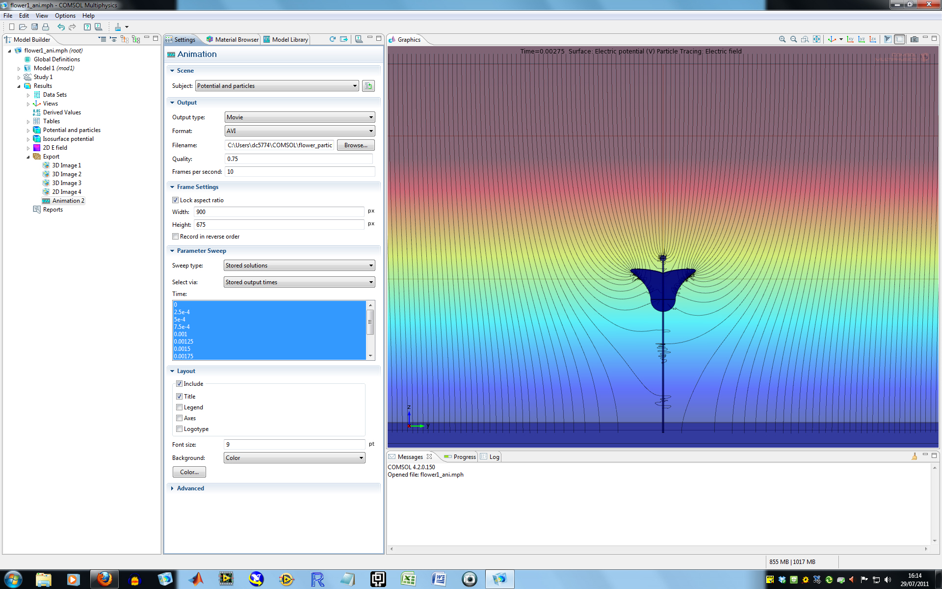

I've been trying to animate a particle tracing plot. I ran a time-dependant solution, and when i plot the 'particle tracing' for each time point I get the frames of the animation I want to create. The problem is, when I export an animation, in whatever format, I see only the final frame.
I dont know if there is a bug or if this is my fault, I can't see any way to do anything differently with my solution. I have attached a gif of what it should have looked like (made by exporting individual images from the plot window) and a screen capture of my animation node. I can't attach the model because it is too large with all the solutions.
Can anyone suggest where something might be going wrong?

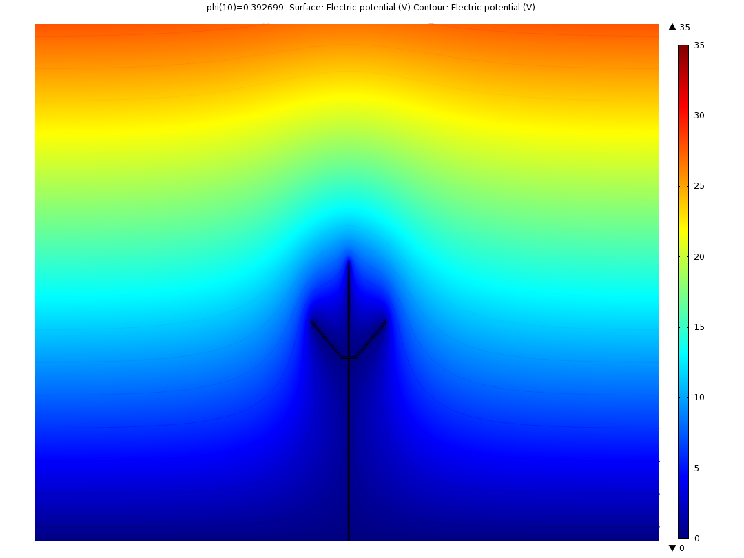

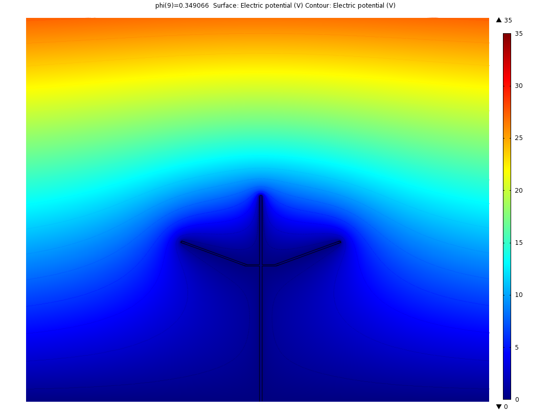

Working on further animations I am coming across some bugs. Some of the frames (a sizeable minority) are being resized; squashed horizontally, while others aren't.
Is anyone else experiencing troubles with animations in comsol v4.2?
Please help.
I have attached some images to illustrate.
Kind regards,
Dom.
